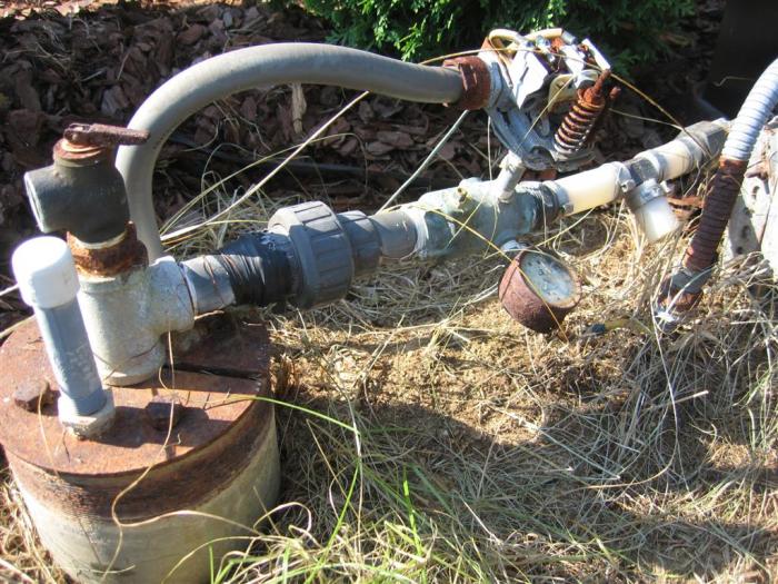

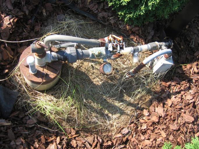

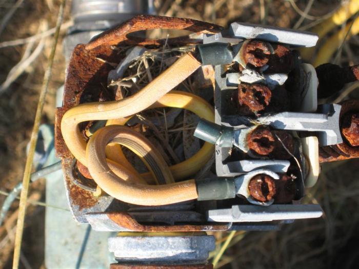

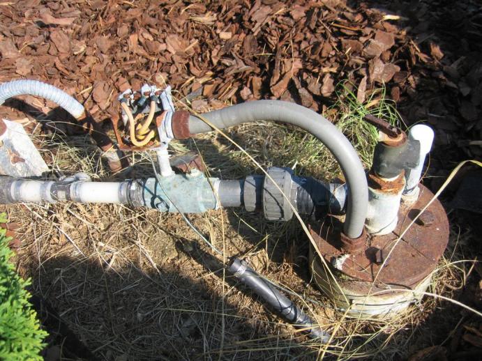

    I have a well on my property I'd like to make operational again. I am told it was taken out of service about 6 or 8 years ago prior to our purchasing the property. I've attached some photos since I have no data on the well or pump. What steps should I take to see if the well & pump still work? Can you tell from the photos the type of electric supply (110 or 220?) If 220, how many wire? My thought is to use a portable generator to supply power and direct wire the generator to the pump leads. Hopefully water will come out of the pipe. If it works, I'd have to provide proper electric supply from the house panel along with all the appropriate controls and piping. If I am on the wrong track, please give me step by step instructions for testing and restoring the well. I plan to use the well for irrigation and general use outside the house. The house has a new, working well system.

    Since that's steel casing my bet is that the old one developed a hole in the casing, which was why the new one was drilled. The previous homeowner should have properly abandoned this well.
    If that's not the case then I would bet that the pump is locked up after sitting for so many years. Most submersible pumps are 220, you will need a minimum 3500-5500 KW generator to run the pump. Looks like a two wire pump, no control box.

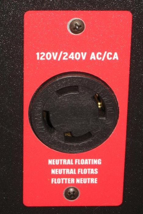

    My generator is more than adequate to handle the load, but I'm unsure of how to hook up the plug on the generator to the pump wires. Any suggestions?

    Once I've hooked up the generator to the pump, how long do you think I should wait for water to appear or is there some other feedback to tell me if the pump is working or not?

    Use a voltmeter to tell which of the 4 prongs gives you 240 volts. Hook those two prongs to the two wires going down hole. Then use a clamp around ampmeter to see how many amps the pump is pulling. The largest the pump could be is 1.5 HP which will pull about 11 amps. If it pulls more than 11 amps the pump is bad. It should only take a fes seconds for water to start pumping if it is pulling the right amps.

    The wiring for the L14-30 plug is;
    NEMA L14-30
    W (Neutral)
    Y (Hot)
    X (Hot)
    Ground (Green)
    You will be using the Y and X, and it would not hurt to have the generator Grounded for safety.
