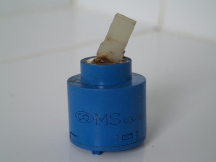

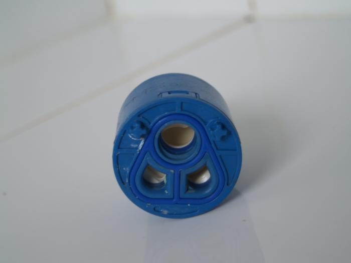

    Can anyone please help me identify this shower mixer cartridge. The only information printed on it are the letters "MS" and the date. See attached photos. Thanks.Name:  cartridge2.jpg

    The good news is that it is identifiable. The bad news may be that it is a CFG #7009, and around here that would mean it was not readily available, since we have NEVER seen a CFG valve in this area, and it is not one of those valves which has parts interchangeable with some better known brand.

    Cleveland Faucet Group, Part #40017

    I don't know if you do much work like in apartments,...but Cleveland Faucet Group ( a Moen company) is widely used these days in that market. May not be a builders brand in your area, but it is in some areas. Pretty decent value brand, and parts are readily available. If the valves have just not "arrived" in Sedona yet your local suppliers may have to order the parts.
