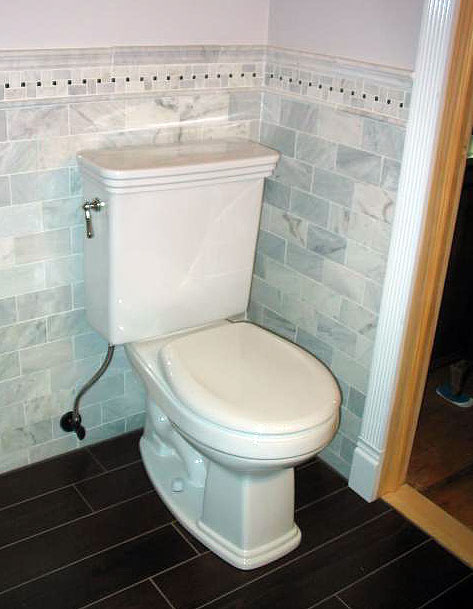

    Can anyone tell me how the Promenade compares to the Ultramax ll as far as reliability and flushing.

    Pretty similar
    Same trapway, flush valve and fill valve.
    Different rinse.
    The Promenade has a straight down the bowl rinse, while the Ultramax II and Drake II have the swirling rinse of the "Double Cyclone"
    The Promenade can be ordered with or without Sanagloss in the whites; the Ultramax I and Drake II come with Sanagloss in the Whites only.
    CST423 Promenade
