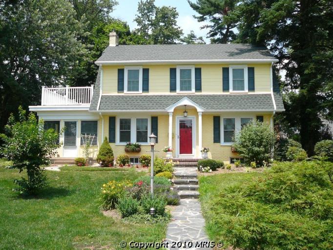

    I need flat roof advice / options. I’m purchasing this home and there are minor issues with the flat roof. I never wanted a home with a flat roof but in any case…there is living area beneath this roof.
    I don’t want to be the homeowner that has flat roof leaks that either goes unnoticed or that require constant maintenance. I’d love to convert it into a deck – or am I looking for trouble? I don’t know what’s out there that is tried and true, any ideas? Am I better off having it pitched and using regular shingles or just keeping it as is? I believe it is painted on tar substance – it’s not torched.

    The best flat roof protection is probably a continuous membrane. If you decide you want to tile it, there are several methods that also would waterproof it. The roof needs some slope so stuff doesn't pool and if it can't slope to the outside, needs a drain of sufficient size, with the area sloped to the drain (similar to a shower). www.schluter.com makes a system that is designed to tile an outside roof deck, but if you don't want to tile it, and the area is walked on, you need something else. Most membranes are not designed to be walked on, but many can support an applied, floating wear surface on top of it. Flashing is critical on any roof, but even more so on a flat one, along with proper drainage.

    I'd go with a continous membrane, adhered to at least 2" of foam insulation. That way if there is a cut in the membrane it still won't leak. Also, there are special pads for flat roofs so you can sit pavers on top of the membrane safely. They will protect the membrane and allow water to flow underneath, and have shims so that the paver surface is flat. I do this in commercial architecture on a regular basis.

    Yes, Commercial roofers do it all the time. I'd go with a TPO 60mil min. membrane over blue ISO board mechanically fastened to the deck, and the membrane adhered to the foam. They might have a piece sitting around that would cover your entire roof... These are the type of paver pedistals I was talking about... http://www.appianwaysystem.com/ appian way system. There's other companies out there that do similar stuff but this can do extra height because you can use PVC drain pipe as part of the stand.
