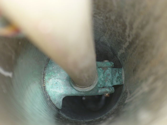

    Default Pitless picture
    Name:  pitless adapter.jpg
    Here is the pic...

    It looks like it may be something like: http://www.baker-mfg.com/domestic_ne...s/Bulldog.html

    Kind of, but there is no pull-cable on it - or even a hole for a pull cable to go. It looks to me like this (which I just found a minute ago):
    http://www.merrillmfg.com/product/02...-Kit/parts.htm

    I am starting to think that I just need to pry up on the tab near the pin. As you can see from the pic, there is no safety cable attached to the pump. Is that a good sign - like the pump isn't very far down? Or is it a bad sign - like the company that installed it was too cheap to attach a rope to the pump?

    Quote Originally Posted by WellWaterProducts View Post
    Is "something like", the same - only different? :P
    My pitless has a steel release cable that moves a cam. I'm not seeing any release cable in the photo. It looks like a hinge pin on a cam but how is the cam rolled?

    Quote Originally Posted by mortal798 View Post
    Ja, I was wondering if the release didn't go down the inside of the pull pipe like in the link you posted.

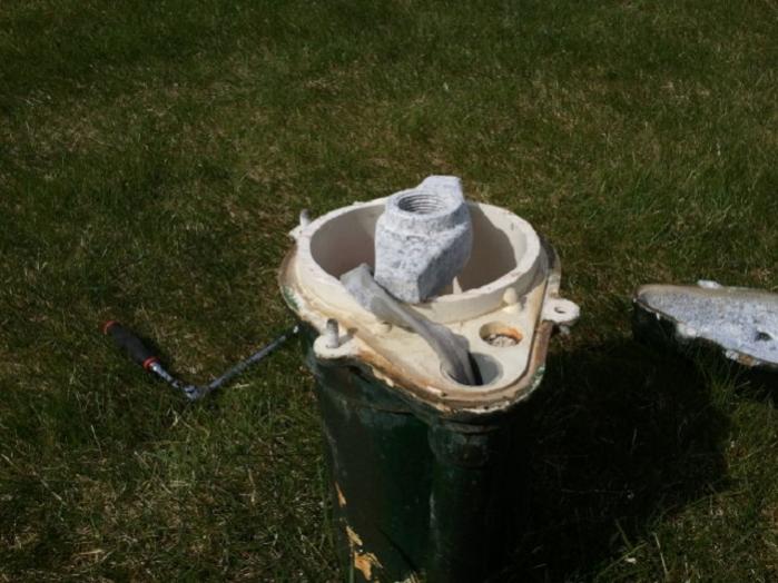

    Default Top of well
    Here is the top...Name:  Top of well_1.jpg
    In the trades WellWaterProducts's Avatar
    Feb 2011
    Northwood NH
    126
    Look at the link for the product and it takes you to installation instructions. From what I remember, you need to be very careful when removing it to not lose the oring.

    Moderator valveman's Avatar
    Mar 2006
    Lubbock, Texas
    3,539
    I believe that is one of those kinds of pitless adapters that you need a tool to unhook. I believe you need a rod with washer welded to the bottom. The washer works like turning a screw with a coin. You reach down in that 1" pipe with the rod, stick the washer into a groove, and turn it to the left to loosen the lock. At least that is my best guess.

    Installation Instructions
    1. 1. Cut and thread 1" pull pipe. (See chart for length). Assemble support bar, pull
      pipe, and pitless body. Be sure that arrow on support bar and discharge hole on pitless body are in line with each other.
    2. Cut a piece of 1/2" pipe 3" longer than pull pipe and flatten one end to fit stainless steel screw or weld on adjustment tool to one end of 1/2" pipe.
    3. Measure distance from bottom of support bar to center of discharge hub, or use assembly as a measuring stick.
    4. Drill hole in casing, the same measured distance as above:
      4" casing - 1-1/4" hole or smaller
      5" casing - 1-1/4" hole or smaller
      6" casing - 1-1/4" hole or smaller
      NOTE: For 2" MCK model - 2" hole or smaller
    5. Notch or mark top of casing directly above discharge hole.
    6. Clamp discharge hub around casing to assure watertight seal around discharge hole.
    7. Attach pump and drop pipe to pitless body, apply Anti-Seize/Gasket Lube to
      O-ring, and lower into casing.
    8. Line up mark on support bar with notch cut in casing.
    9. Turn stainless steel screw clockwise until O-ring seals on inner wall of casing.
    10. Complete installation by installing watertight or ventilated cap on top of well casing depending on state well code.
