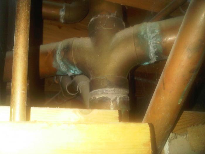

    I'm getting ready to install a Drake II to replace 1 of my Am Std 6 gal toilets (ca 1968). It will be "back-to-back??" with 1 of the old toilets. There is about 2 ft of drain on either side of the (cross-wye??) fitting to the stack and sewer drop to the basement.
    Will I need to make any change to that fitting.
    Picture of fitting...Name:  Minnetonka-20110616-00023.jpg
    14,202
    Gerald,
    That is not the best fitting for back to back toilets.
    But in a pinch it would work. They can force air back, which pushes the water up in the bowl and when it drops, it may lose some water.
    At least it does in my home.
    21,405
    My guess is yes, but wait for a pro. The newer toilets tend to have a pretty high velocity outlet and this can cause the discharge to cross over and do weird things with the toilet opposite it. That's why you need the proper fitting, it directs things down the drain, and won't allow it to cross over. Older toilets may have used more water, but it was a much slower exit than the new ones and thus didn't have (most of the time) enough energy to cross over.
