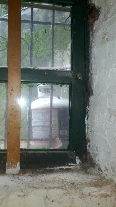

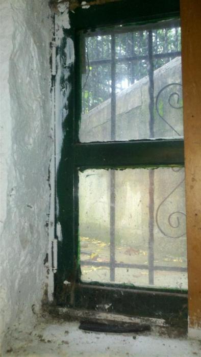

    Ok, a picture's worth a thousand words.. so heres a few pictures to help you guys understand the situation.

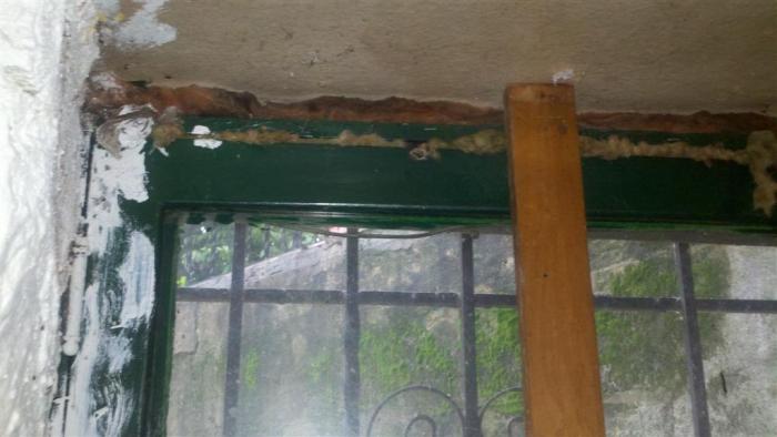

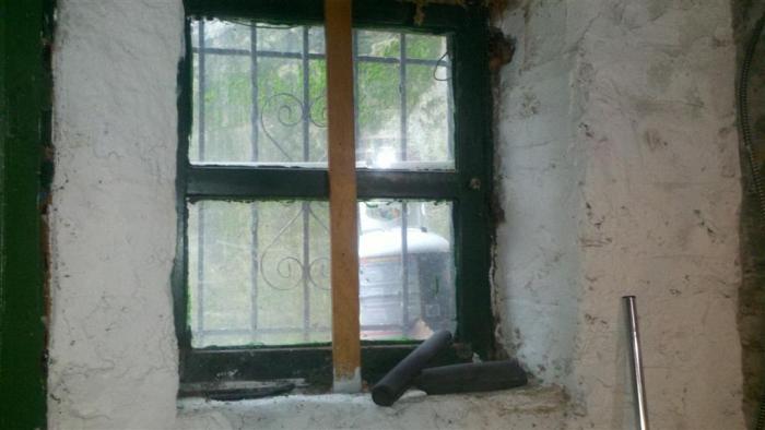

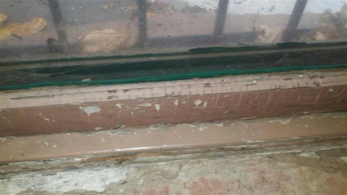

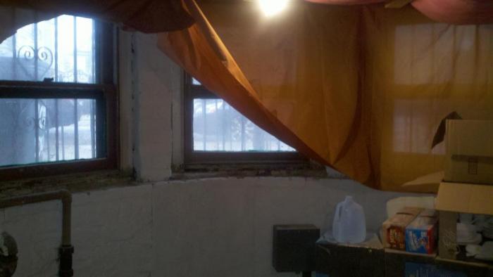

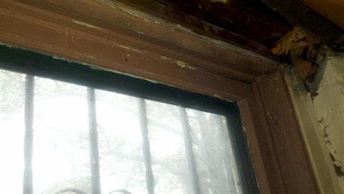

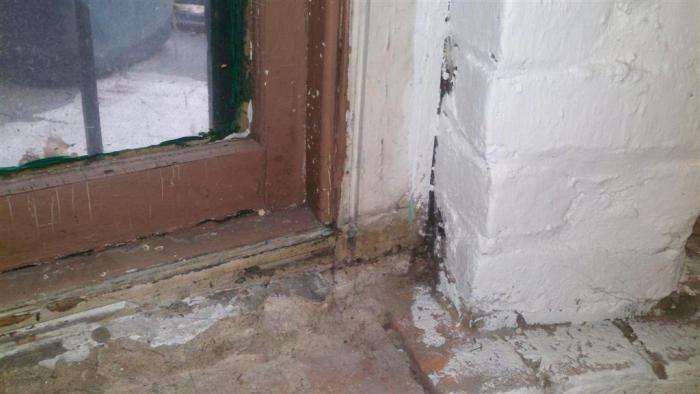

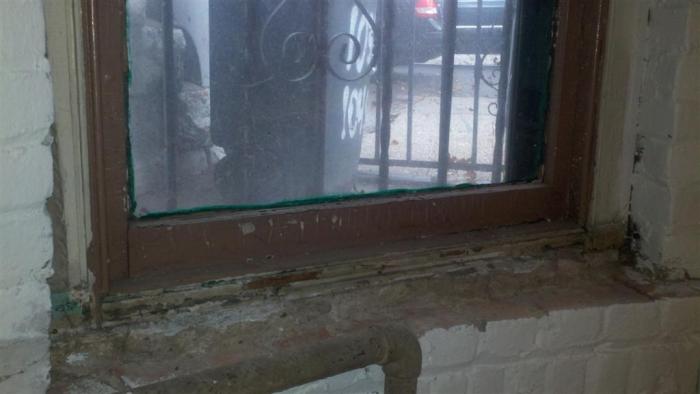

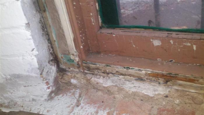

    Ok, the first 6 pictures are the front of the house. As you can see, there are 3 windows like this, right next to each other (8-10" apart). The last 4 are in the back of the house, and the foundation there is deeper than in the front.
    There seems to be a 2x4 type wood around the left/right side of the front windows (see 3rd pic), but I'm not even sure if that's part of the window itself, or a buck. SHould I remove it ? It looks like there's brick, then concrete stuffed between the wood and brick. My guess is if I remove that wood, I'll have to remove the concrete too, correct?
    I really don't care what the window looks like, no need for wood or anything fancy. I just want something durable that will last. Are any of the windows at lowes/HD any good? I haven't had a chance to go to lowes yet, and Home Depot carries the American Craftsman (which I heard are crap). They are vinyl, double glazed, and super cheap (<$120 each, 36"x38"). I suspect they must be garbage at this price though.
    TO clear this up, wood is out of the question. This is eventually going to become a rental property, and I wouldn't be painting/caulkng the windows regularly. So, it's between Aluminum, fiberglass, and vinyl.
    I've watched a few "window installation" videos. Drilling/installing Tapcon in Brick, or CMU is easy. Drilling a stone foundation, not so easy. It looks like I meet brick in the front windows, but the back is stone. I am anticipating a problem here, attaching the window or even the buck to the stone foundation.
