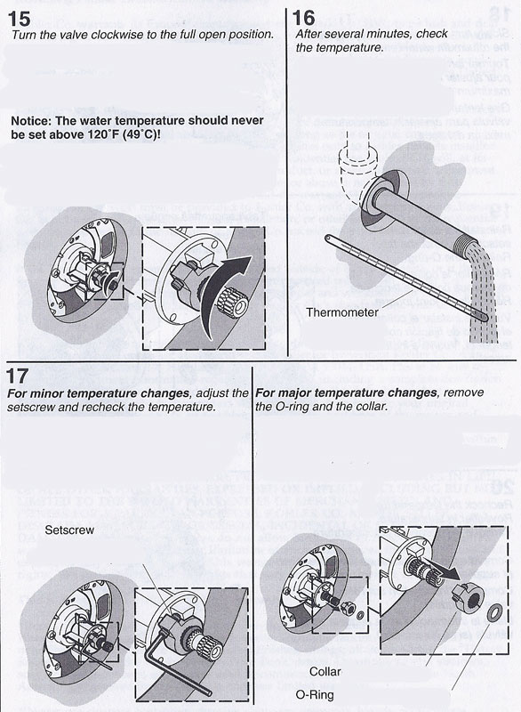

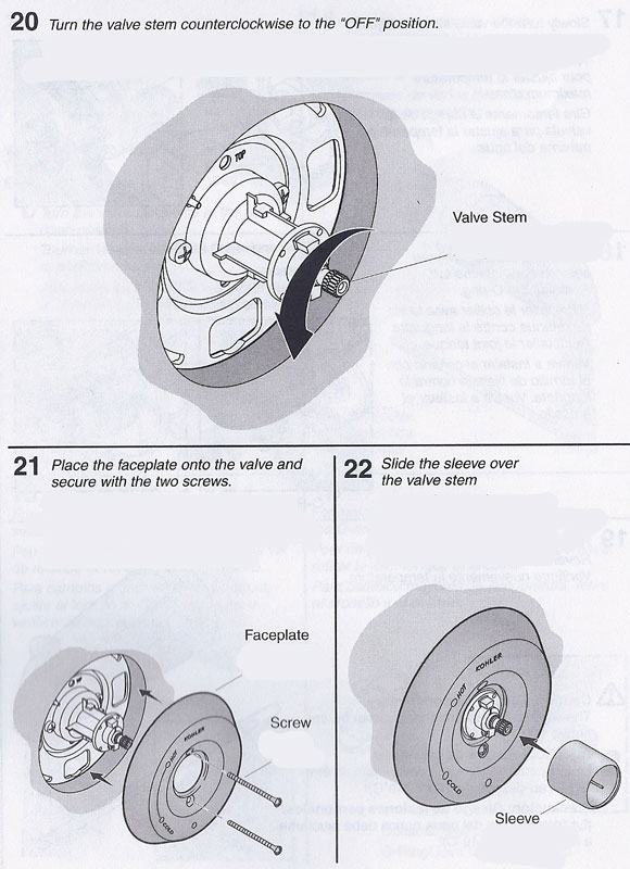

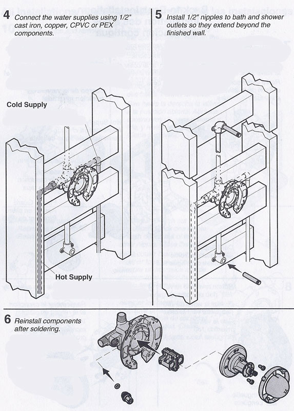

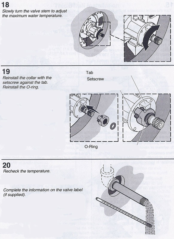

    Installing a Kohler Rite-Temp pressure balance bath & shower valve, K-304
    Rough in instructions from Kohler with some added tips.

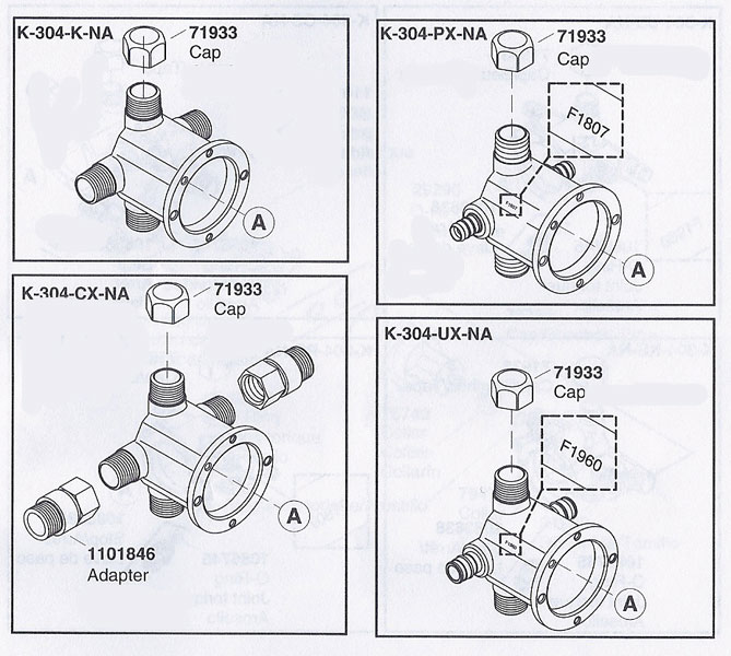

    Most plumbers will remove the cartridge, and solder pipe to the valve body first, and then reassemble the valve. The valve comes with the option to thread on a "female adapter", or to insert copper pipe into the brass body of the valve. I prefer to solder copper pipe to the valve.
    two
    two, The pipe to the tub spout needs to be full size. No PEX here. PEX is undersized for a tub spout and will force water up toward the shower head. Either copper or threaded pipe like galvanized or brass. I use either copper or brass. Galvanized will rust and the first time you open the faucet in the morning, you will get some rusty water.
    three, if you have a back to back installation like below, you can reverse the valve without making the pipes cross over.
    four

    One "minor point". Valves which have the option to solder the tubing directly into the valve, have MALE threads, so you would have to use a "female" adapter, NOT a male one, to connect to the valve. And do you really think plumbers or most handymen/DIYers read the directions?
    I just went back and made that edit. It was Sunday, what can I say?

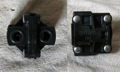

    I have loads of water pressure however, after installing the K 304 valve and turning on the water nothing comes out except a couple of drips. It's like the flow is restricted somewhere. I removed the pressure balancing unit and confirmed that yup, loads of water pressure.
    Could my pressure balancing unit faulty right out of the box as it seems to be restricting the water flow to the point of nothing coming out?

    Is it a tub and shower Or shower only? If shower only check restricter in shower head.
    DIY Junior Member bananavida's Avatar
    Jun 2011
    Belize
    Since it balances pressure, it needs to be equal from the hot and the cold side.
    If the water heater is turned off, then no water will come out.
    Is the water heater connected?
    One other note; it rotates in the opposite direction from the Moen Posi-Temp.
    Well now that makes sense. We don't have a hot water heater yet, so that is not plumbed in, just the cold water is. So, if we plumb it so the cold water comes up the hot water pipe as well, then it should work? Where I am cold showers are still pretty warm.
    21,405
    As long as both the inputs see similar pressure, then yes, the valve should open and work 'normally'. Course, you'll have no temp adjustment, but you probably knew that.
