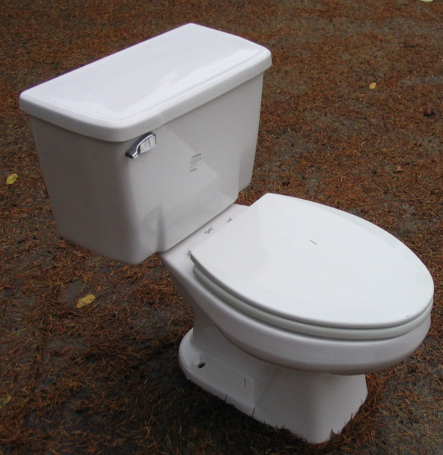

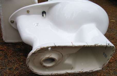

    Mansfield Quantum
    The Cadet gravity is a so-so toilet. Having said that, there are tens of thousands of them in use in homes, apartments, and hotels.
    A pressure-assist will work better. I have a Mansfield Quantum, and gladly accept the noise in exchange for better flush.
    Inside the
    Mansfield Quantum tank, Flushmate equipped.
    Under the Mansfield Quantum
