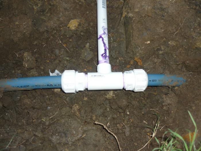

    I am installing an irrigation system in my yard, and am tapping into the main water line. It is 1" pex pipe, and I plan on using some pex compression fittings connected to a PVC tee for the sprinklers.
    My question is, how reliable are these pex compression fittings? This connection will all be buried underground, and after making sure it isn't leaking when I attach it, I will cover it with dirt and likely never see it again. If it ever begins to leak, I will never know.
    Another question... how else can I tap into a 1" pex pipe? Thanks.

    Seems to me a PVC irrigation system would be simpler and less expensive. You'd only need to transition from PEX once. I'd got to copper from the transition point to the back flow device, then transition to PVC. You could go with PVC instead of copper, that is just my personal choice.
    25,655
    What do you mean by "PEX compression fittings"? The simplest would be a PEX tee with PEX to the backflow preventer, (you are going to install one, aren't you?), and then PVC from there.

    Yes, I am installing a backflow device. I am running pvc from the main pex waterpipe to the side of the house where everything will be located (valve box, shutoff valve, backflow preventer, etc...)
    the fittings I am asking about look similar to this...
    They are not threaded and fit right into a 1" pvc tee. The guy at my plumbing specialty store recommended them and said they were made for pex pipe. Once I get it put together, and make sure it isn't leaking, can I cover it with dirt and forget about it forever?

    That fitting is for ips pipe, such as PVC, NOT a cts line such as PEX. I would prefer copper also, but if he is going to run plastic, PEX might be preferable since it would not snap in two when the lawnmower hits it.

    HJ, that is not the exact fitting, that just looks similar to it. I couldn't find the exact one I used.
    I got it all put together today and had no leaks. Ill leave it exposed for another day or so to make sure its still solid, then bury it. Thanks for the help
