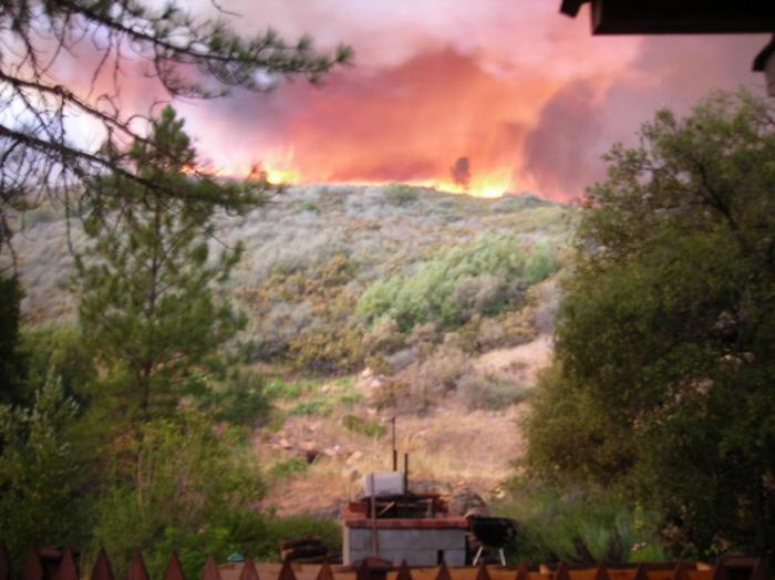

    As to the fire departments, egad! In our hundred year fire storm, the fire department assured all the locals they would give each house a truck and stand by. Only the 3 or 4 of us that stood firm have houses now, and the rest of the neighborhood looked like Dresden. I drove about just after the main flames passed through, and not a single "public servant" was anywhere to be seen. I could have saved 10 houses with a single garden hose each.

    As to the firefighters, they didnt pick a few defensible places to save, they just left the area. Many houses were destined to burn, as the owners made no effort for brush clearance, and built with dry old wood siding. And large eave vents that let embers into the attic.
    I built a house of cement and stucco, no eaves and no eave vents. 1" sprinkler on the roof. Generator. All for about the cost of a 50" TV and entertainment center with accessories. But some houses were saved by bizarre miracle that had fire burning right up to the cedar siding, and other by a guy with a little hose just putting out spot fires. Australia has a program to tell people to stay, as most fires are caused just by embers dropping about the yard and roof.
    Building codes now require sprinklers inside, tempered glass everywhere, and self closing vents with 1 hour siding. But the roof sprinkler was left out, the key item.

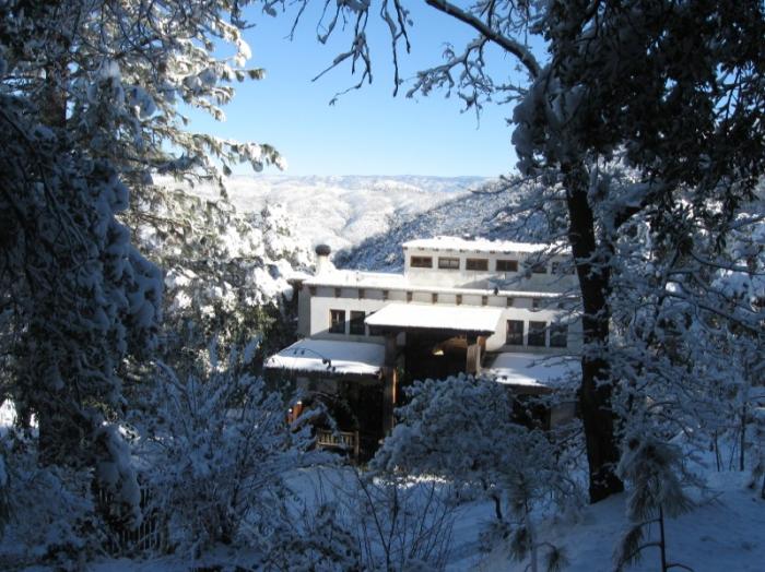

    I am the designer and builder. At the time they made a 16x16" concrete block with two cores, one for steel and cement and another for vermiculite or foam. Dry stacked them for about 1.5 stories, with many 1" threaded rods to pretension it to the foundation. Other areas and stories of large timbers sawn on site and redwood framing. Sheathed with boat-ply [you will never touch the home-dopey stuff again after using real plywood], then 1" of fiber reinforced stucco.
    Essentially flat roofs with a parapet wall - small eaves, but of poured concrete. Crushed slate on the roof, and all interior floors poured concrete for radiant and fire resistance between floors, as in a hotel. Be sure never to have any wood decks on a house - I poured cement over timbers, or used cantilevers.
    This is a gold mill - water mill site from the 1850's, so it steps down a hill toward 2 streams. I have two wine-root cellars that I cut and cover into the mountainside, one over 70' deep, so such a back-up is essential in case things got dicey. A company now sells a sensor system that detects heat from an oncoming wildfire and turns on misters on eaves and roof. You dont need a lot of water, just a lot of humidity.
