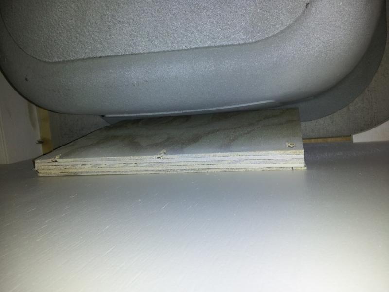

    DIY Senior Member TJanak's Avatar
    Sep 2009
    South TX
    150
    This is what my granite installer did on all four sides of my sink. Holding so far.
