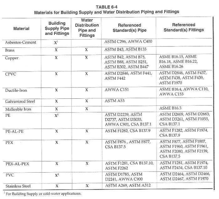

    Here is an excerpt from the 1997 UPC code book
    604.1
    third line reads: Asbestos-cement, CPVC, PE, or PVC water pipe manufactured to recognized standards may be used for cold water distribution systems outside a building.
    CPVC water pipe and tubing may be used for hot and cold water distribution systems within a building.
    However, in the 2009 UPC code book, if you look at chart 6-4, it has this little statement at the bottom of the chart for PE and PVC
    1, For Building Supply or cold water applications.
    It appears that the more recent code book allows PVC for cold water applications inside the building.
    I would still check with the local inspector though, to make sure that, I'm reading that right, and that you inspector is reading it that way too.
