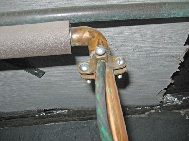

    All -- first post so be gentle. I have a cold water copper pipe that runs above my garage and supplies the outside faucet on our house. It runs above our electrical panel and has the panel ground attached to it. This pipe is prone to rupture during winter months (this is another issue and a longer term fix). It ruptured again and I would like to replace the entire run of pipe including the section where the ground is attached. QUESTION simply is -- is it ok to temorarily remove the ground so I can replace the pipe and then reattach it? I just want to make sure I am not going to short out the house or put ourselves at risk. If I can remove it, I assume handling it is ok or are there specific instructions on this as well? Thanks guys and gals.
    The setup is similar to this:
    http://www.google.com/imgres?imgurl=...4&tx=134&ty=45

    No problem, there should be no current on the ground wire,
    feel free to disconect the wire, do your repair and put it back.
    As long as your electrical system is in working order you will have no problems.

    Thanks Michael -- so it sounds like I remove the ground from the pipe, then replace the pipe, then reconnect the ground in the same location, in that order.
    25,624
    If removing the ground wire causes a problem, then you ALREADY had one and that just revealed it. I once removed an electric water heater. The utility's neutral wire had failed, and the ground wire was a piece of BX sheath which had rusted off. THerefore the only neutral/ground was the water piping and when I disconnected the heater the system lost that connection and EVERYTHING in the house reverted to 240 volts burning out everything which was operating at the time.

    Jdenike, are You confused yet ?
    If you see sparks when you disconnect it, then you have a problem, and should connect it back and find the problem.
    If You do not see any spark then you should be OK.

    If I understand it properly, that wire is to 'bond' the water pipe in case it accidentally came in contact with a power lead. Instead of now having your entire plumbing electrified, it would short it out to ground, and should trip a breaker(s) and prevent you from getting electrocuted by touching it. There should not ever be any power or current or voltage on it. If you were using a plastic pipe (say pex or cpvc), that wouldn't exist, since that pipe can't conduct, thus, no safety hazard.

    Thanks guys - the house is relatively new -- 1987 -- so I suspect the ground is pretty straightforward. I will proceed and replaced the pipe and reconnect it after I am done.
