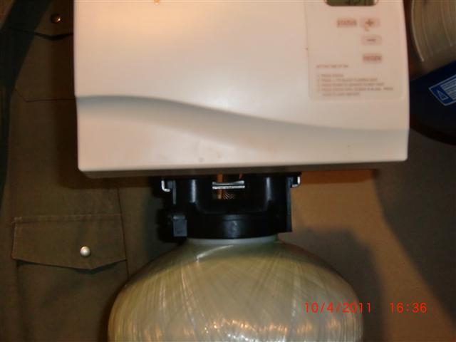

Hi everyone.
Here's my situation, I have an Iron remover from Culligan which does the job with my 4.8 PPM
of iron with the aerator setup. I need to get the valve cleaned about once a year as it gets dirty
and the flow really becomes a problem.
As I told the Culligan man, I really like the guy but ate the invoice that comes with it.
Not sure I can do the cleaning of that valve as I was watching him doing it...
Can another valve be used on that bottle????
Is there another valve that would be easier to maintained???? or that would not need such
a cleaning every year????
Regards...:confused:

You could have another Culligan valve there and replace it when the time comes to change and then clean the one that came off the system.
If it is loading up within one year or so then most likely other valves will do the same in the same time, it is the nature of the way the iron is getting removed from your system.
How long does it take for him to clean the valve?

If the Culligan goes onto the tank with two legs then it is only the culligan valve that will fit the tank and no other valve.
The fleck 5600 would not be a good one for that ,,, no way of changing any of the times with in the cleaning cycle like the 2510.

is this what you mean with the two legs??????
Akpsdvan
1,542
15
Alaska
There are the two legs, or the in and the out for that valve body and the part that screws into the tank.
The other is that the tank has "Their threads" they are squared off not like the pipe thread that most other tanks use.
So even if you had another valve, fleck, autotrol or clack.. it would not screw into the top of the tank like the culligan adapter that is between the valve and the tank.
