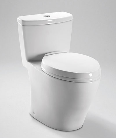

    I went to the TOTO website & found they are introducing the Aquia ONE PIECE dual flush toilet. It only comes in Universal height & unlike the Aquia III, it comes in all of their colors. I called my local store & they didn't know about it, but did see in their books it is coming out 2nd quarter this year - which is now. They will be calling their suppliers on Monday. I was told it goes for $600 in white. Does anyone have any reviews for this toilet, yet?

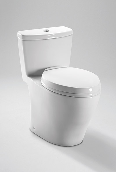

    This list price in white is $750.00 which translates with discount to a Seattle area price of $525.00
    It looks pretty similar to the other Aquia bowls, except for the tank being molded to the bowl. That should make for a nice installation.
    I expect performance to be like the others based on the spec sheet.

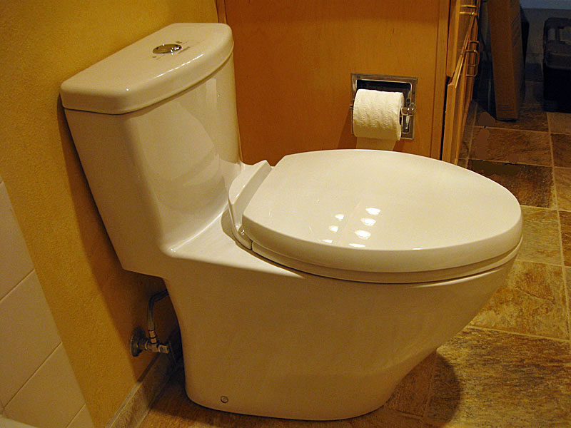

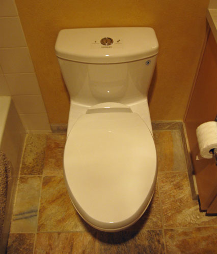

    This toilet was installed with a less then 12" rough.
    Notice the room behind for the shutoff valve.
    This Aquia was made in the USA.

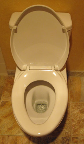

    With the SS204 seat down
    With the SS204 seat open

    My concern is the water spot size in this model. One of the photos you posted in this thread with the lid open looking down into the bowl would seem to show a very small water spot. My concern is 'skid marks' and the bowl rinse to remove them... I have read a few complaints about this issue on your forum with the Aquia line. I'd like to make an informed decision and would like your professional opinion...

    Because a dual-flush wants to empty the bowl, regardless of which button you press, the bowl volume must be smaller than with a single flush design. Otherwise, you'd be leaving behind some waste when you flush. As a result, since you want some depth to cover things during use, the surface area is smaller. For the area to be the same, it has to be shallower, and to many, that is more objectionable. Skid marks are very much dependent on diet and aim...most Toto seats are uncomfortable unless you plant your butt over the water spot which helps unless it is an explosive discharge!
