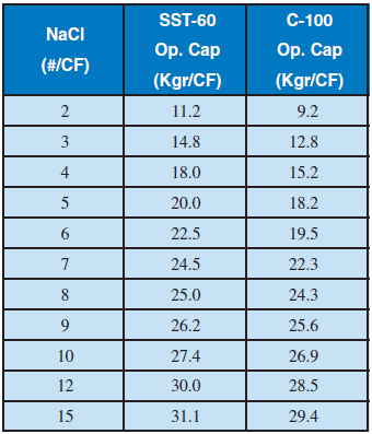

On the SST60 from Purlite here is a capacity chart.

Yes I have the same picture.
I don't see your 33K with 9 lbs, or 12 lbs/cuft. And you sure don't get more K with the use of potassium chloride, you can figure you need up to 30% higher salt dose using it depending on your salt efficiency setting; the higher the more PC percentage you need.
Question... I see that 9 lbs/cuft in a 1.5 cuft softener would be 12 lbs per regeneration, and... 30K at best for SST-60 right? I think that means that the k of capacity is dependent on the type and cuft volume of resin used, no? So why talk of reducing the PC volume to 9lbs when you don't know how much capacity they need to be able to regen every 7 days?

I do agree with Gary on the point that what we are speaking about is almost relative in terms the capacity at this point is uncalculable with out seeing what the raw water makeup is like. traditionally you get more capacity out of sst60 because of the shallow shell technology rather than actually using less salt. The salt savings is due to higher capacities pre cu3 of resin.
