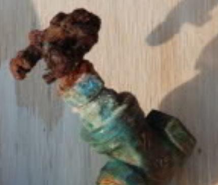

    I see plenty of old gate valves on water service lines that I wouldn't touch...
    And by not touch I'm not evem going to move the handle a fraction of a turn....
    Name:  Screen shot 2011-04-01 at 12.25.34 AM.jpg
