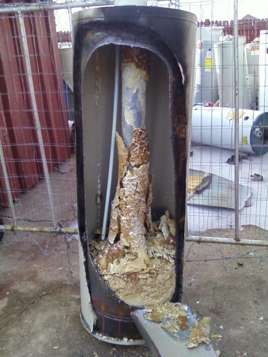

    does a water softer shorten the life of your water heater
    14,202
    It is a prime example why you need
    a water softener in the mid west .....
    the fellow did not have a water softener , this heater was 10 years old
    and they had 7 people living in the home when it finally started leaking in the garage........
    usually you use about 300 per year to heat your water,
    my guess is he probably used 3 times that much to keep this pig heating water...
    he was still not interested in doing anything about it...
    the water softener would literally pay for itself in gas savings pretty quickly

    The aluminum /zinc rods are an excellent fix for supplies that have the sulfur odor when it is not caused by SRB but by other problems. Gary is correct in that a quick heating of the water above 140 is a good test and many countries require that tanked heaters be maintained at 140, Not only for SRB, but it is also beneficial for controlling much more dangerous pathogens including legionellas etc.
    FYI, the problem is much more common in electric water heaters than gas, and almost non existent in tankless designs. It is simple physics, the electric heating rods locations allow for the water in the bottom of the water heater tanks to stay cooler (below 140) and the accumulation of sediment and other "stuff" help to grow the bacteria. The Gas fired heaters heat the bottom up and "cook" the pathogesns. Terrys picture shows it very well, the "insulation" can become quite excessive and the amount of energy required to heat the water is considerable.
    Thanks Terry for that picture. It is better than the one I have. Can I add it to my training seminar? I will credit you for it of course.
