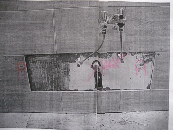

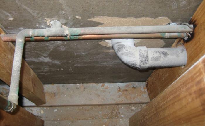

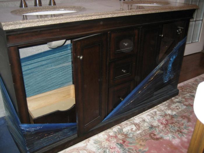

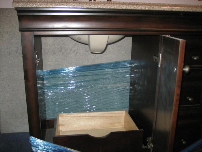

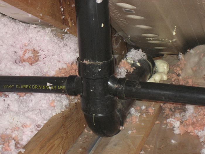

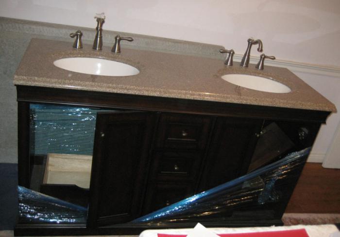

    Morning everyone, hope everyone is well.
    I've been racking my brain trying to figure out the proper way to extend the supply lines as well as drain/vent assembly, but would prefer some advice since this forum came highly recommended. I'm located close to Toronto Ontario, Canada and am a sheet metal worker by trade. I'm comfortable sweating pipes as well as working with abs.
    Details:
    Picture #1,2.3
    Vanity is 61" with an open back so I'd like to make all rough in close to the sink with shuts offs. Since there are drawer in the center that will make installation much more easy I'm hoping.
    I have more pictures and details as well as how I believe it should be roughed in but I'm only allowed 4 images so if I'm allowed I can post more on another post.
    Thanks
    Frank

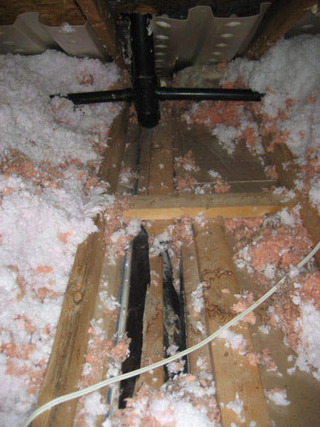

    Seems it's been merged so I'll carry on.

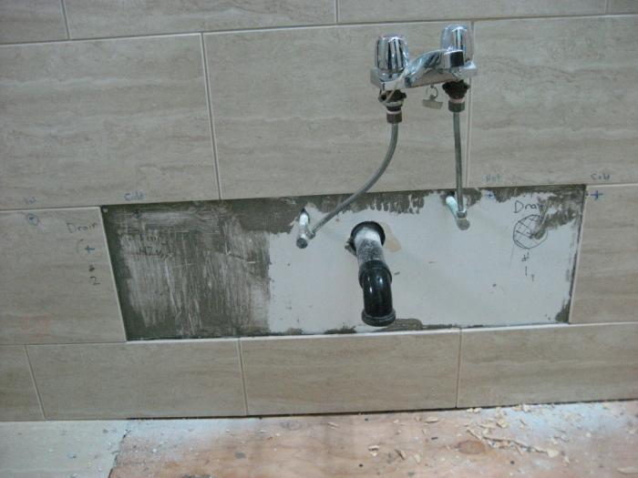

    Picture #4
    This is the present rough in and I've given rough dimensions where both sinks will be set. Builder didn't put any shut off so I improvised. Oh and I know I shouldn't have tiles so much but I got carried away.

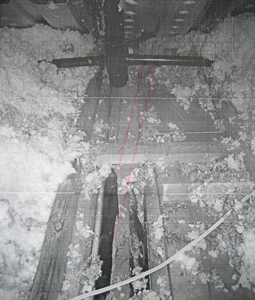

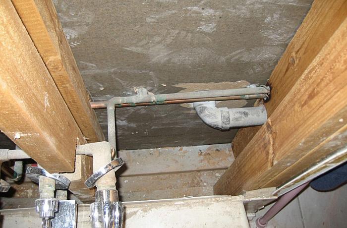

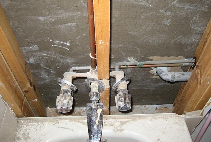

    Picture #5,6,7
    I'm going to renovate a second ensuite bathroom next so rather then open up the present bathroom I removed the main shower/tub wall in the opposite bathroom since it seemed the logical route. Therefore....this is what is inside the wall but only up to a 33" length.

    I'm not pc savy so this was the only way I could do photo's.....sorry. Since I believe the original drain is vented via the main stack, I'd like to place another vent between drain #1 and #2 vertical into the attic and accross and "T" into the smaller abs. Are the highlighted marks visible?
