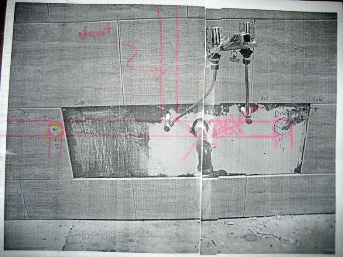

Just found this picture

I searched this forum to find this picture from a thread created last year...
attachment.php
Dlarrivee
1,150
Canada
How would that be any better than the double santee.
Look at what Terry posted, do you a see a double fitting of any type there?

Incorrect, the offset of the stack is created with wyes and 45s, not santees... the santees are where the trap arm ties in...
You need 2 wyes, 2 santees, 2 45s (street in his photo)... and pipe obviously...
You already have 2 90s, but are they long radius or vent ells?
I'd be installing a clean out below the lower wye myself.
