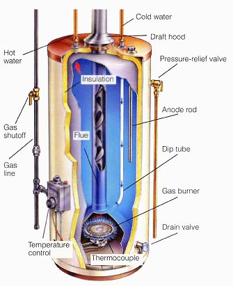

A water heater is designed with a "dip tube" that puts the new incoming cold at the bottom of the tank. Heat rises, so the hot water if pulled out of the very top of the tank.
You can reverse the order, but you won't have as much stored hot water ready to use.

Also note that on some WH, you can relocate the dip tube, so in fact, it may be okay (other than the markings!). You'd possibly do that to minimize reworking all of the supply lines to keep the burner controls facing out, rather than backwards into the wall. You'd have to ask the plumber if he did that, otherwise, you'll end up with effectively a smaller WH because of the way it dilutes the hot water with the incoming supply. There should be a shutoff on the inlet...there could be one on the outlet, but that's not required. that may be one way to tell.
