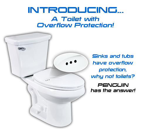

    Hi All,
    I discovered the Penguin Toilet and would like to know if anybody has any experience with them. I'm looking for a toilet that is least likely to clog and overflow. The penguin has been used by some apartment complexes and housing authorities.
    Here's the Penguin:
    http://www.penguintoilets.com/

    That is hilarious.
    What happens when you get a clog downstream of the trap way?
    Yakima WA
    6,843
    I think I'll stay with my two Toto toilets that don't clog to begin with.
    23,547
    The "trap" for the overflow feature REQUIRES water to flow into the overflow openings or it will dry out and allow sewer gases into the room. That will only happen when the toilet is plugged and ready to overflow.

    It does appear that the overflow is not tied into the main trap. Could this be resolved if a whole-house trap was in place? It won't stop a clog beyond the trap, but no toilet can do that. The Syracuse, NY housing authority is apparently using these.

    Frankly, from the looks of the bowl, it's very likely to get plugged and need snaking. So they put in overflow holes so the people can keep using the toilet without clearing the plug.
    It would make more sense to get a bowl that doesn't plug, or even if you do plug it, will take three flushes before overflowing the rim.
    I have seen, and used bowls that will overflow with two flushes on a plugged bowl. One that comes to mind is the Gerber 21-712. That was horrible.
    Unless they are getting these for $75.00 or less, I can't see the point. A good toilet isn't going to overflow.
    If they are worried that tenants are going to plug the bowl, and then have a leaking flapper, and leave for the day, then I guess it makes sense. Kind of like expecting babies to change their own diapers. Someone has to clean the mess for these people.

    The picture I see of the Penguin reminds me of the Mansfield trapway design that we take out. Maybe they have changed it from the picture, maybe not, but based on our experience in the real world, I don't like see those two sharp bends. There are plenty of bowls that will "MaP" out pretty well, assuming you use 3/4" x 4" plastic missiles. In the real world, they aren't wrapped in slippery plastic, and the sizes are different. They also don't try flushing toothbrushes or make up pens. I find my share of odd things between the two sharp bends, so I would naturally feel better about it if the picture didn't show that flaw.

    You could take the flapper out of a toilet and let it sit, and unless you also plugged it, it won't overflow. So, Not really sure what advantage that is except being another pathway that could get plugged up and then not work when those weird conditions called for it to work. And, as mentioned, if the main line is plugged, it won't make any difference! Unless I'm missing something, it doesn't magically shut the water supply off, and that would be the only way it might work; it only provides another path down the drain.
