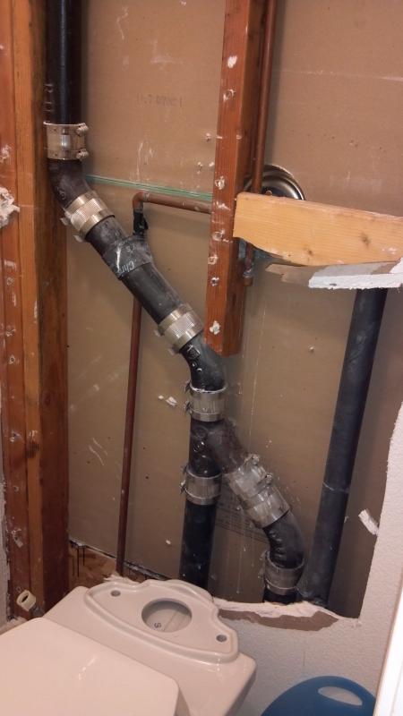

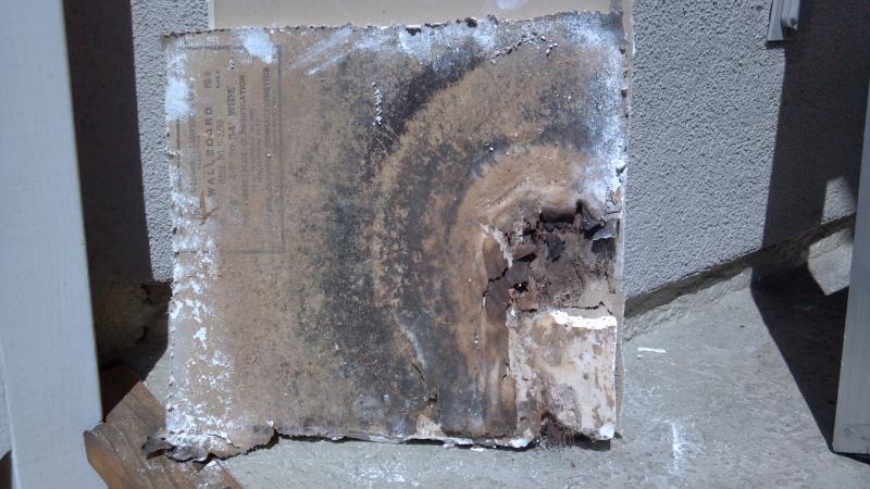

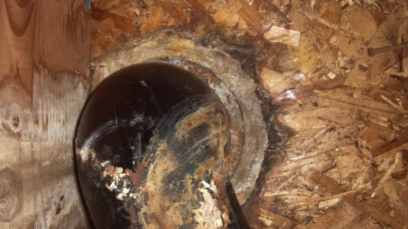

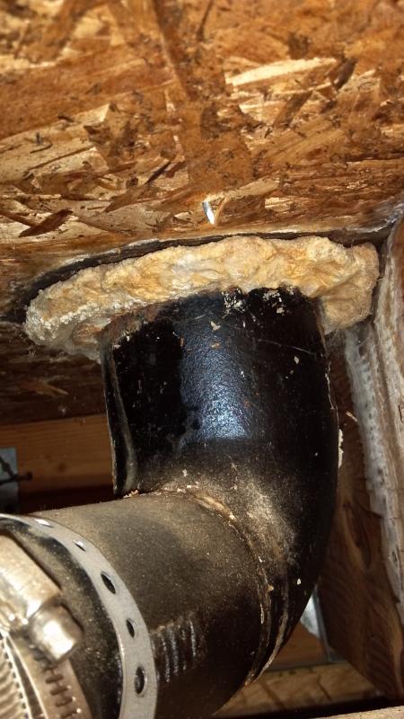

    Thanks for the replies. We did some destructive testing and here is what I found. (See attachments)
    Had plumbers in they did the following:
    - opened up ceiling below the toilet, found mold on the drywall. we inspected throughly and it was only located around the area under the toilet. I knew it definitely leaked at some point, so not too surprising.
    - determined that the toilet was no longer leaking since the ceiling was dry and we flushed the toilet a 100 times almost. (still hasn't leaked for last two weeks)
    - this cut open area did NOT smell.

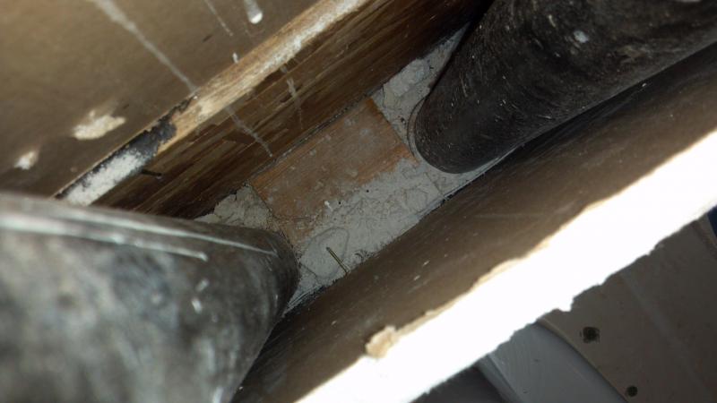

    Water closet and shower share a wall - there is a smell in that wall. The plumber suggested that there could be a damaged vent pipe, but unlikely since it's all cast iron.
    He suggested opening up that wall and have them come out again. After opening up that wall (see pictures), I see no visible damage. One of those pictures is looking down - don't see any water damage. The water closet smells stronger now.
Size:  36.0 KBName:  2013-03-31_22-07-11_417.jpg
    I went up to the roof to find the vent. I found it but its too hard to safely reach for me with my shoes (I need some spikey shoes). But not sure what I can do from up there anyway.
    Anyways, not sure how to diagnose this now. Should I wave incense around to see air movement out of that wall? I heard about some some sewer gas detectors (Hydrogen sulfide?). Read about that here:
    http://fritzing.org/projects/hydroge...tor-sewer-gas/
    Should we do a peppermint test? Smoke test? Pressure test?

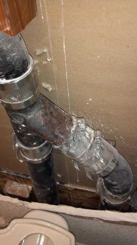

    One more pic for perspective. Note the shower is on the other side of that wall (see the valve)

    Holy cow, that is quite a lot of weight pressing down on quite a number of coupling sleeves. Have you sniff-tested them all? Honestly, regardless of whether it's the cause - if it were me I'd rip that cast iron vent stack out and run PVC from that first coupling sleeve all the way to the roof and strap the heck out of it where it enters the attic to relieve down-force. Someone will probably tell me why that's wrong, but that's the first thing I'd do!
