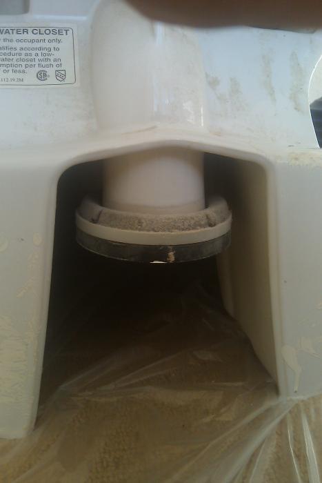

    Hi All,
    I have a Toto toilet (single flush, no gadgetry) thats about 5-6 years old in our masterbath. Its in it's own little room in the bathroom. We have a constant smell in there even with the fan running 24 hours a day and door shut. See some pictures attached.
    Setup:
    - there is about 1" between the back of the toilet and the wall. On the other side of the wall is a shower. Toilet is on the 2nd floor.
    Here's some history:
    Part 1
    - drain flies appeared and I noticed some water leaking behind the toilet. There was a smell
    - I removed the toilet to find a big brown slurry mess and the unifit adaptor. The rubber seal from the unifit stuck to the toilet when I lifted it off. That appeared to be the leak point, but hard to tell.
    - after cleaning I removed the unifit, cleaned more, scraped off the wax ring. cleaned more. Flange is metal.
    - replaced the wax ring with a #10 (not quite a double high ring) as the flange is slightly below the floor by about 0.5"
    - put the unifit back on. cleaned rubber seal, attached the rubber seal to unifit, seated the toilet.

    I would bring the bowl outside and clean the underside well. If there had been leaks, you will want to make sure it's clean before resetting.
    I sometimes take toilets onto the lawn and use the garden hose on them. Water isn't going to hurt it.
    I would also replace the Unifit adapter if the seal has come off. It needs to be set with with wax to the flange, making sure there is compression on the sealing.

    Forgot to mention I did a wipe down with bleach solution on the underside of the toilet and in the crevices from the back. Possible that I didn't reach every nook in there.
    Are those rubber seals supposed to hold on tight to the unifit? I can't see how they could. Unless they are supposed to fit entirely inside the unifit, and not have the outer lip hang outside of the unifit with the inner lip inside. That seems like an awkward fit.
    12,429
    The seal is installed tight. I've never seen one loose like that, and I've seen tons of them.

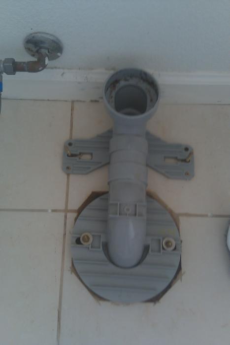

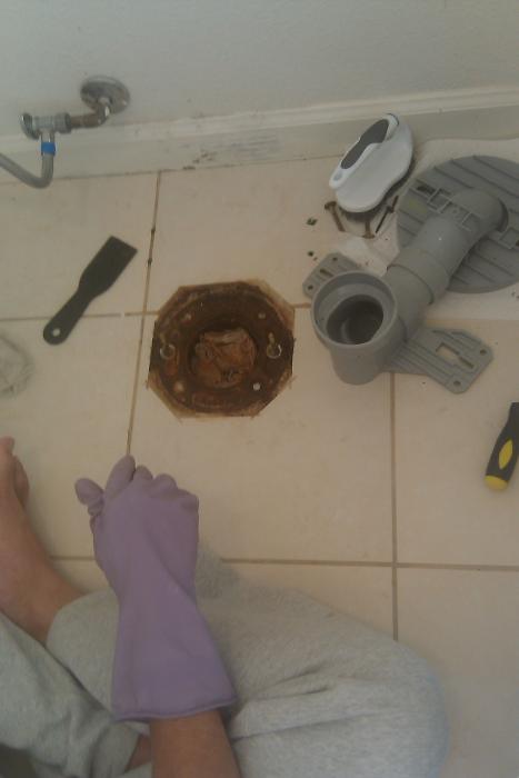

    Resurrecting this old thread - we still have a smell. Here's what we did since
    1) brought plumber out back in March 2011. We cleaned the toilet. And he installed a new replacement unifit adapter. I asked him were he though the smell was coming from, he couldn't smell it (I think he lost his sense of smell), although admittedly it wasn't too bad at that time since the room was aired out. He said it could be coming from outside some how. I don't see how that's possible, unless its coming through the exhaust vent. He didn't think it was a problem with the flange/drain.
    2) A couple of days after he came out, we still had the smell. I hired a couple of guys to help me thoroughly scrub the toilet, floors, and walls of the bathroom with windex. No change after this.
    3) I removed the unifit, and plugged the drain with a test plug. I caulked around the test plug and around the flange just to be sure, no change. Test plug looks somewhat like this: http://s7.cdn.hardwareandtools.net/i...id=225&hei=225
    The test plug has stayed there since April 2011, sealed up. The unifit and toilet remain uninstalled. The smell never went away, but we aren't running the fan 24/7 anymore, more like once a week and we keep the door shut.

    Back to the original post. We did the following:
    1) Installed the original toilet (new unifit adapter). Smell increased significantly after installation (before we had the drain sealed up with a faint smell). To me that indicated something is just plain wrong with the unifit or the toilet.
    2) Bought a new toilet (Drake II, no unifit of course). Installed it. Same smell. Doh!
    3) Smelled inside the wall from the other side (opened shower escutcheon plate) - IT SMELLED!

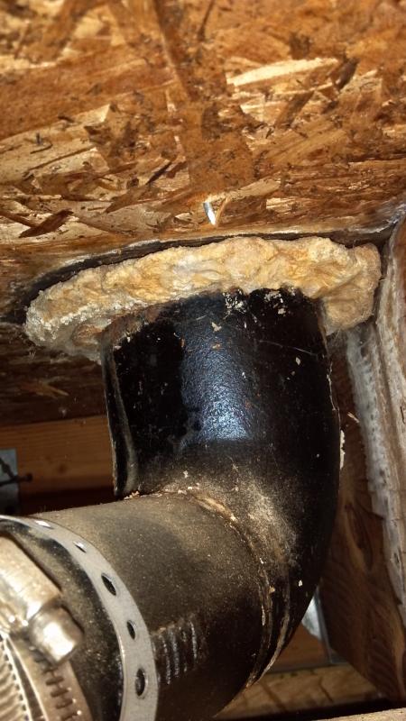

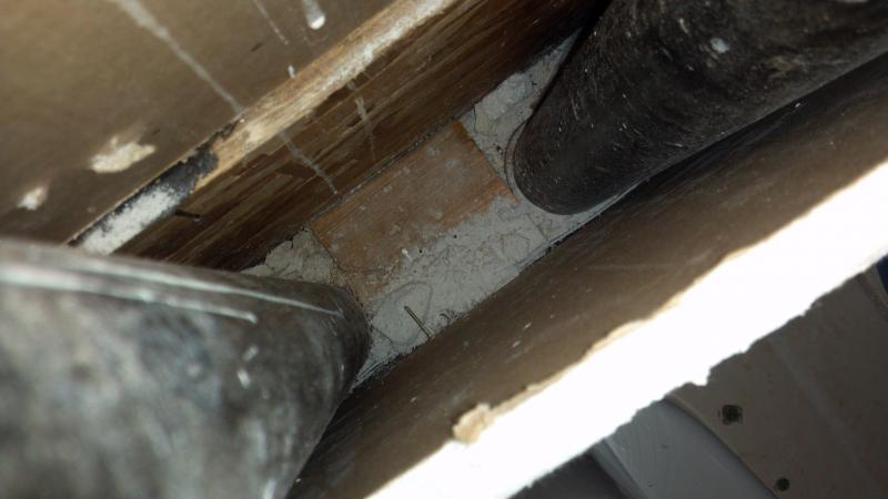

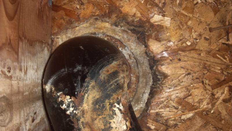

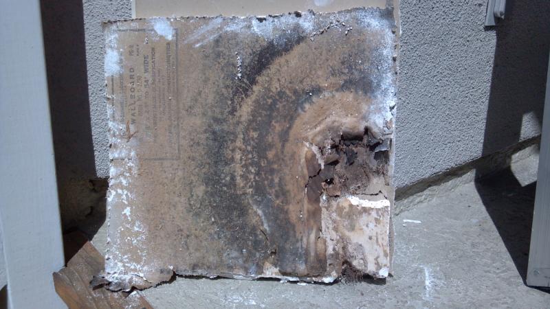

    Thanks for the replies. We did some destructive testing and here is what I found. (See attachments)
    Had plumbers in they did the following:
    - opened up ceiling below the toilet, found mold on the drywall. we inspected throughly and it was only located around the area under the toilet. I knew it definitely leaked at some point, so not too surprising.
    - determined that the toilet was no longer leaking since the ceiling was dry and we flushed the toilet a 100 times almost. (still hasn't leaked for last two weeks)
    - this cut open area did NOT smell.
    Water closet and shower share a wall - there is a smell in that wall. The plumber suggested that there could be a damaged vent pipe, but unlikely since it's all cast iron.
    He suggested opening up that wall and have them come out again. After opening up that wall (see pictures), I see no visible damage. One of those pictures is looking down - don't see any water damage. The water closet smells stronger now.

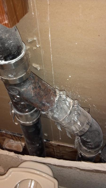

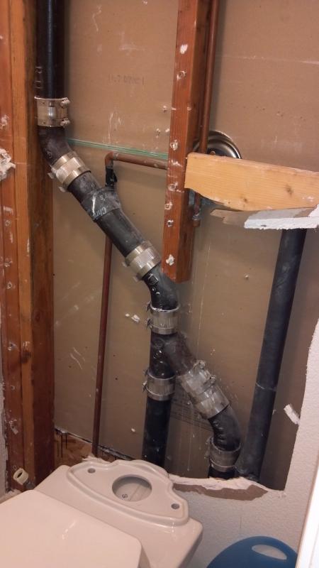

Size:  36.0 KBName:  2013-03-31_22-07-11_417.jpg
    I went up to the roof to find the vent. I found it but its too hard to safely reach for me with my shoes (I need some spikey shoes). But not sure what I can do from up there anyway.
    Anyways, not sure how to diagnose this now. Should I wave incense around to see air movement out of that wall? I heard about some some sewer gas detectors (Hydrogen sulfide?). Read about that here:
    http://fritzing.org/projects/hydroge...tor-sewer-gas/
    Should we do a peppermint test? Smoke test? Pressure test?

    - the shower and sink area certainly don't smell - the sinks are 6-7 feet away from the water closet. The shared wall between the water closet and shower smells. Maybe I'm misunderstanding you, how could doing what you say stop a smell from coming out of the water closet?
    chrisf8657
    - now that the mold and mildew idea is out. Your ideas of pulling the molding - still need to do that.
    - subfloor looked clean from underneath
    - drain flies have been gone for 2 years.
    - will have to investigate the shower pan - any idea how to easily do that now that the wall is opened up?

    One more pic for perspective. Note the shower is on the other side of that wall (see the valve)

    Hire a professional plumber that can do a smoke test.

    Holy cow, that is quite a lot of weight pressing down on quite a number of coupling sleeves. Have you sniff-tested them all? Honestly, regardless of whether it's the cause - if it were me I'd rip that cast iron vent stack out and run PVC from that first coupling sleeve all the way to the roof and strap the heck out of it where it enters the attic to relieve down-force. Someone will probably tell me why that's wrong, but that's the first thing I'd do!
