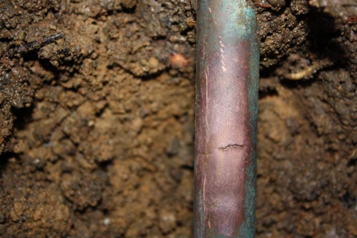

    As I expected, 3/4" copper. I suspect that the service has been replaced at some point, as the valve box riser at the property line is plastic pipe.
    Anyhow... there is a lateral rip in the pipe. Nice of it to be on top, so it is easy to see! I have done a temporary repair with a bit of bicycle inner tube and a hose clamp.
    So, should I go with compression fittings to fix this? I can see that being a bit difficult, requiring me to dig back many feet in each direction from the break so that I can lift each side of the cut in order to fit a compression union in. Or is there some sort of nice prefab repair coupling that can be slid onto one side, then over the gap, then tightened up? Any trade names or part names that will help me track down what I need will be helpful.

    If you can find a "Dresser coupling" or something like it for 3/4" copper, you can cut the pipe at the break, slide it on to one side , pull it back onto the other side, and tighten the two "draw bolts". My biggest question would be the "grade" of copper since that is an "unusual" type of failure, unless it is type "M" or refrigeration copper tubing.

    In my area we see type L copper failers quite often. It may have to do with the soil conditions.

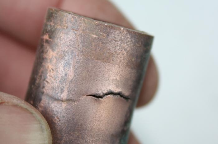

    I suspect the failure is due to the tubing being cold worked - bent too far and then returned, creating a weak spot, as the pipe in the vicinity looks a little "rolled" for lack of a better description - this could be an installation error.
    Thanks Michael and John - I understand that I need the correct size for copper tubing, I will try to find such a repair coupling.

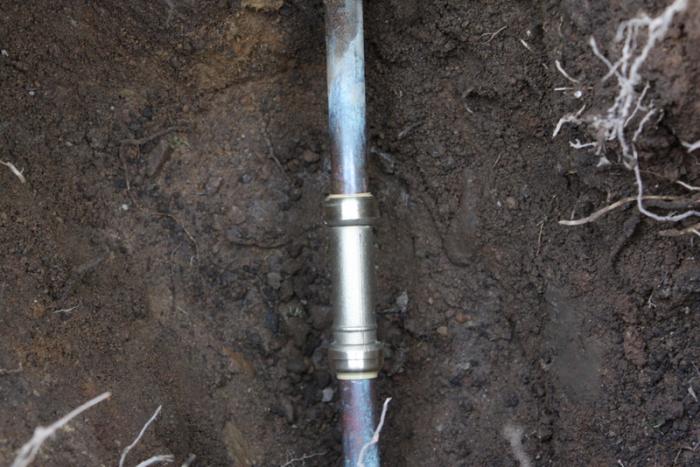

    All I could find at the supply house this morning was a Sharkbite slip coupler, and standard 3/4" couplers (not slip couplers).
    I wanted the slip style to make things easier, and the Sharkbite was less than half the price, so I went with it.
    http://www.cashacme.com/prod_sharkbi...p_coupling.php
    I was a bit nervous that it wouldn't work, as I was concerned that the pipe in the vicinity of the repair was perhaps ovalized a bit, and also I figured that once I cut the pipe, the two sides would not be in perfect alignment.
    However, it all went well and just took a couple of minutes. Below is a picture of the coupling in place, and a closeup of the failure. I remain convinced that the failure was due to some damage to the pipe during installation.
