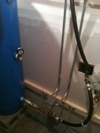

I recently replaced my water tank(no bladder), check valve,sniffer valve and switch,

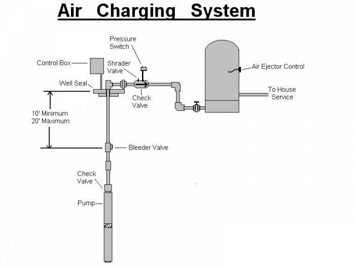

I have a Air charging system (submersible about 100 feet with a check valve at the pump and another before the tank, 1/2 HP 115v 3 wire control box).
This was a straight swap basicly nothing changed.
The problem that I am having is the loud slamming only when the pump starts,my first guess would be the new check valve before the tank!!!
Anything I should try before I buy another check valve?
The switch is a 30/50 and is set at 32/55
