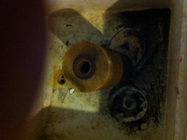

    Making some progress today. I think I fixed my softener with a part I didn't install In the process I changed the filter and this is what 1 1/2 months looks like. Some of it is metallic looking stuff. Happy wife happy life. I need to keep reminding myself of that. Most of the sand and crap is from this filter change
    Derek
