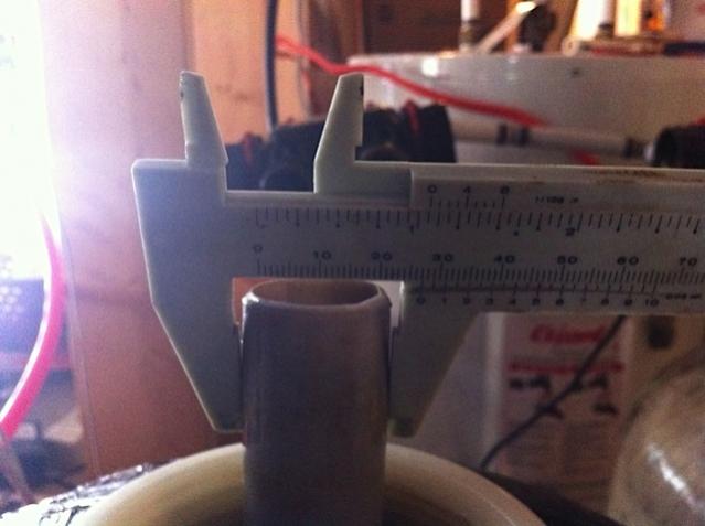

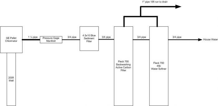

I need help to figure out why my water softener has never worked and if I need to replace to whole unit or fix the problem. I’ve created a separate post on figuring out if the rest of my set up is sufficient.
Current set up is attached. Last water test results are below. A few times a year I used to get Iron Bacteria from the well.
I installed it 4 ½ years ago and it has never worked.
I had someone out to look at it and they said the following.
1. That the backwash flow was too low with the ½ pipe I had shared between the softener and the carbon filter. ( this is now upgraded to 1â€)
2. That the media could be dead due to chlorine pass-through from carbon filter, I ran it in by pass for a few weeks thinking it would be good to kill any iron bacteria.

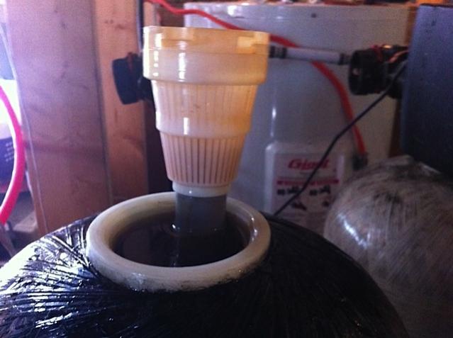

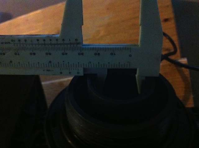

I took apart the unit this morning and found that the down pipe in the unit is not making a tight seal in the fleck 700 head. The pipe 1-1/16th and the opening for it in the head is 1-1/4th. See attached pictures.
I assume this is a problem and that I was sent the wrong down pipe assembly when I bought the unit online.
Can some one confirm this? Based on my water test should this unit be sufficient in softening my water and removing the iron and manganese with chlorination?

I am going to work on the valve,
A) dump the upper baskets, I have found Iron and upper baskets do not play well together.
B) The valve looks to be set for the high flow with out the the high flow distributor down through the media. one part will fix that .. Fleck part number 61419 it will make up the difference between the valve body hole and the distributor.. and have all the water stay where it should and not cross over giving untreated water.

Thanks ! I actually found that I had that part. It's all back together now and I'm running it through a cycle. Can the experts recommend settings for the fleck 7000 based on my posted water test? Given that the media likely sat there for 4 1/2 years stagnant will i need to change it?
