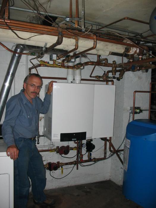

When converting a residential boiler from oil to natural gas the procedure never varies. You will, by the way, be cutting your carbon foot print in half, lowering serious pollutants such as SOx and NOx to sub-California standards and if done properly, will likely lower the operating cost of your hydronic heating system by 25% or more.
Every proper boiler replacement starts with a heat load analysis. You can do the math on fuel consumption from one year or five, but the outdoor design temperature may not agree. A manual 'J' takes into account important factors such as climate and most importantly, building materials. Radiation should be measured as a factor in sizing the appliance, particularly as fin-tube was regularly sized for 180F° average water temperature. If the heat load indicates that the radiation is close to design, you will need a boiler that can produce 190°F (some condensing boilers don’t). Fortunately, this condition is rare.
If you don't perform a manual 'J' you don't know what your doing.
High efficiency condensing boilers save fuel in several ways.
First, they are sealed combustion and direct vent, eliminating chimneys drafting conditioned air to the outside and uncontrolled cold combustion air from entering the house. Typical condensing boiler stack temperatures are 120°F instead of 320°F.
Second, all condensing boilers now come with outdoor reset built in (if you install the outdoor sensor) and modulate the burner to maintain the minimum boiler temperature needed to maintain the temperature at the thermostat. In most systems this will have the boiler in a condensing mode for the majority of the heating season and save more fuel than any setback thermostat while creating more comfort.
Third, a condensing boiler is low-mass with virtually no standby losses. This is in stark contrast to you old oil boiler, which had to first heat several hundred pounds of cast iron just to keep the chimney hot. Add the tankless coil and you have a recipe for waste (and an obscure fuel usage number, which will be of no use in sizing your new boiler).
Finally, in regard to high efficiency boilers “AFUE” is only marginally useful, as a condensing boiler will be at steady state efficiency in a matter of a few minutes (86% minimum combustion efficiency regardless of return water temperature) and a cast iron boiler may take a half our or more to hit peak efficiency, never reaching 86%.
From this information, you can see that choosing a high efficiency condensing boiler is really easy. The question then remains, which one and who should install it. If an experienced professional sizes your condensing boiler by a dedicated heat load program (dedicated to hydronics) you will then have the most accurate heat load estimate that can be had, taking into account existing radiation, insulation, windows and the quality of construction.
When choosing a contractor to replace your old boiler, eliminating those who can't show you a sample heat load analysis, generated by dedicated software, will make your list, if not your search, much shorter.
A condensing boiler that is more than 20% over-sized will tend to bump off the bottom instead of modulating flame down to a nice steady (and nearly perpetual) burn, it will be on and off like your old boiler, killing efficiency and comfort at once.
As to sizing an indirect-fired water heater; each must be sized to the domestic load, which is first determined by the largest tub. The indirect should be very close to the size of this tub, as the tub filler will likely draw the tank down in a matter of minutes. This is a few gallons of output for the average condensing boiler and too much for the biggest residential tankless water heater. No boiler up-sizing is necessary or recommended when matching boiler to indirect.
Finally, R13 is certainly more than enough for a basement in most climates but care should be taken to choose insulation that will resist moisture. I prefer XPS but if you use fiberglass do not install a vapor barrier, which is erroneously prescribed in some codes.
Ventilation will be a concern as with any basement bath, but a Jacuzzi is not a hot tub and reasonable care with exhaust fan selection will serve nicely.
Don't be discouraged in your quest for high efficiency boilers. When I installed my American made condensing boiler in 1987 no one could help me...now everybody is an expert. Go figure.
