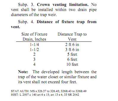

    looking for a chart that show how fare a vent can be from a waste pipe for 1 1/2 2 and 3 inch pipe

    Google "Minnesota Plumbing Code"; the whole thing is available online in PDF format.
