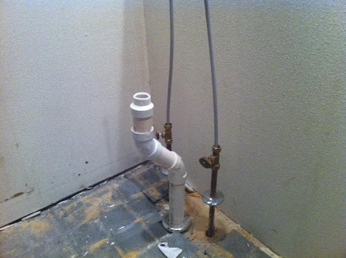

    I am replacing the sink and vanity in my master bathroom, but there seems to be a small issue. The previous configuration had the sink drain into the floor instead of the wall.
    1. All of the pics that I have seen online have the sink drain going into the wall (i this called a P trap?). In addition, all of the vanities that I have seen seem to be designed for the drain to go through the wall as well. Is my current configuration considered an S-Trap? If so, I have been doing some research and it seems like S-Traps do not meet plumbing code. Is this true?

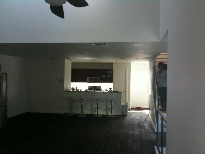

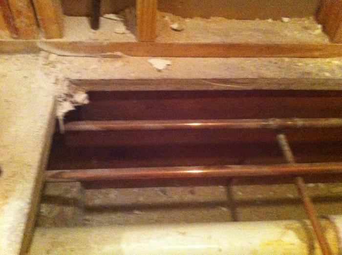

    2. My bathroom "floats" above my living room so there is huge I beam holding it up. This means that there is no room to run the drain pipe behind the wall because I would literally have to drill through the I beam. It seems like my only option to keep the configuration like it is now. Are there any other options?
    3. I have attached a few picks. Pic 1 shows the floor drain. Pic 2 shows the I beam. Pic 3 shows the floating bathroom.

    Well, you have no trap at all yet, but if you put a trap under the sink and then turned down right away into that drain pipe, then it will be an S.

    As much as we dislike the thought of using an air-admittance valve, this would be the place which I would use one.
    To do so, the existing pipe should be coming up out of the floor 17" On top of that install a sani-tee and trap adapter. Off the top of the sani-tee run a straight piece up as high as the vanity will allow and then install the AAV on the top. If you can get the AAV up higher by using a couple of 45's to clear the sink bowl, it would be even better.
    An AAV may or may not be allowed by your plumbing code, but it will work.

    The problem is you must have a trap, and that trap must have a vent. Without either, the sewer gas can come back up the drain and stink up the house.
    Having the pipe in the wall allows a place for the vent pipe to run hidden up through the roof.
    A floating vanity won't be too pretty with a big ugly drain coming up through the floor.

    I believe that the sink drain is connected to the toilet and shower drain, and that drain is connected to a vent pipe.
    I have attached a pic of what I think is a vent pipe in the bathroom

    More trap arm is better, but you're still not venting the drain properly unless you install a santee and at the very least an AAV as high up inside the vanity as possible.
    Personally, I would be opening up the wall, especially if you want to end up with a nice looking floating vanity.

    You would be venting the drain properly if the piping was in the wall.
