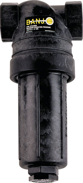

As for crud clogging the sprinkler heads, don't most setups have large Banjo filter screens?
