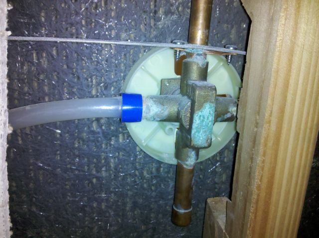

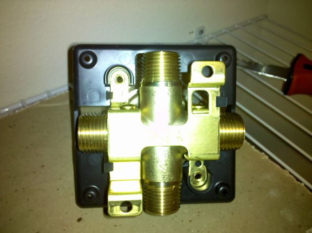

    I'm a fairly capable DIYer, but have never been exposed to much plumbing. I'm remodeling the bathroom and my wife picked out a new trim for the shower. It is a delta set that came with a rough in valve (this is a good thing since it wasn't compatible with the current valve). I thought that when I opened up the wall that I would see something similar to the new one since the house is only about 10 years old. I was surprised to see plastic tubing (I think it is PEX) and no threads on the valve. I was hoping for some suggestions as to what parts/tools I need and what route I should go for making this switch. Thanks

    You did not get the right version of the rough in valve. But you could get a PEX to female IPS adapter, or sweat a piece of 1/2" copper and sweat a pex adapter on it.
    You will of course need a crimper for the pex.
    19,190
    The pex connection looks more like the Uphonor expansion fitting than a cinch clamp. Not sure how well that pex works with cinch connections. In either case, you could install the proper adapter into the rough-in and adapt to the pex. An alternative that the pros may not like, but does meet code, would be to use a Sharkbite fitting - this would allow you to just push in the pex. I think U072 from this page would work http://www.cashacme.com/prod_sharkbite_pushfit.php. You will want to keep the copper for the tub spout and shower head, as the use of pex, at least for the tub spout, will cause problems. If the ends in the wall aren't drop-ear el's, then you'll want to rebuild it with those to provide a solid support (to blocking) for them. This way, the tub spout and shower arm will be sturdy and not flop around.
