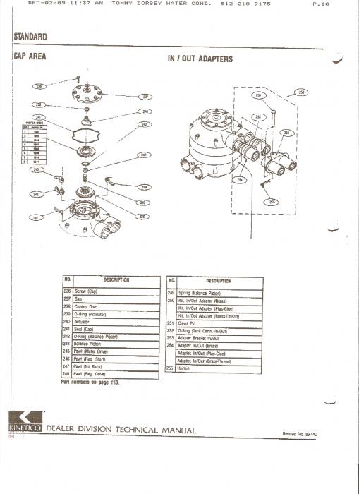

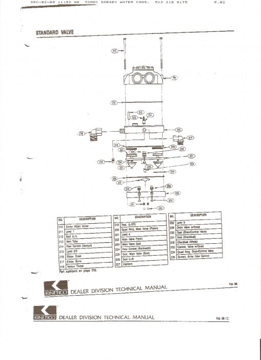

Thanks for the diagram! Any chance you've got it in a larger format? I lose resolution when I expand it. :(
Took the system apart. Only issues I could find are the cracked back half of the bypass valve housing which was obvious before, and the cracked bottom housing of what is shown in the above post on the page "standard valve". That one has numerous cracks around the threads where the bolts hold all the valve sections together, obviously as the ice expanded, trying to push the valve apart.
All the parts under the cap were fine, no cracks in that area, and underneath, all the gears and impeller turned freely, seeming to engage all other gears ok. Need to sit down under very good light to make sure there are no hairline cracks, but if surrounded by water when it froze, the "hard", solid parts should be ok I'm thinking. But I'll look at them again under better light.
Dip tube and bottom basket stuck to the valve assembly for a bit as I pulled it out, so I was able to inspect those, both no problems. Took me a bit to figure out how to get the dip tube back in the tank, but some gentle tamping got it most of the way, and blowing through the tube got it the rest of the way. Hopefully that is all there is to that assembly, and there isn't something else buried in there that could be bad.
