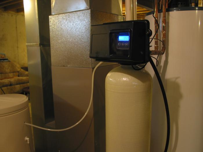

My 7-year-old Culligan no longer softens the water, so I'm going to scrap and replace it. I'm not dealing with Culligan again because of the way they overcharged me on a repair.
Having done my "due diligence" of softener sizing (profound thanks to Gary Slusser!), I'm thinking of replacing it with a Prosoft CS1 EE Metered Smart Memory Model CS1-40K from Quality Water Treatment, doing a self-install. Anyone have any pushback on this plan?
Perhaps an alternative would be to modify my current setup (see photo) with new resin and a new control valve. Is that a better idea?

IMHO 7 years is a short life and I think it prudent to do a forensic analysis on what killed it. Unless you deal with that, the new one could suffer the same fate. I had my softener rebedded after 12 years and what killed mine was probably iron. I had my iron filter rebedded at the same time but will have to rethink how I treat the water.

Hmmm...maybe what killed my w/s is what killed my w/h, which died at age 6 years, 1 month spewing rust. (That's a new Rheem w/h sitting next to the w/s.) Checking with the city water department, our water contains no iron and no manganese. Any thoughts on what forensic steps to take? Hardness here is 8 to 10 grains.

Sounds like the city ran some thing through the water line and your place was hit by what was clearing out of the city water lines.
Normally the city lets people know that they are going to do line cleaning, when that happens if the softener is put in bypass that will save the resin from getting all that junk that might come in.
If you only know of a month, then maybe a large big blue filter before the softener that only gets the filter in the time frame that the city is doing the cleaning.
I am not sure if the Culligan tank could take another control valve..

Was brine removed from the brine tank?
Was salt used?
There are a few reasons why no soft water, bypass not right, a seal in the seal pack assembly out of position and letting untreated cross into the treated side, and the distributor tube out of the valve body and there letting water cross.
The later most likely will have some resin either in the drain or into the house lines.
A car going down the road with a blue cloud is because of a ring that is bad? true or false?
Same thing for the main seal pack and piston assembly.
Was salt used?
Yep--salt was being used up at the normal rate with each recharge.
Something inside the valve body went wrong once before: the unit would reach the end of the recharge cycle, but water kept running down the drain. Eventually, a little "call service" light would illuminate. The first few times I could tap the valve body in various ways, something would shake back into place, and the unit would recover. It got to the point, however, when this procedure would no longer work. So I called Culligan repair. The guy took a look and said it would cost $300 to fix. Seeing the shocked look on my face, he immediately stressed that the repair cost was set by corporate. The part he put in looked like it should cost about $5. I told myself, "The next time something major like this happens, I'm ditching this unit and Culligan." This same valve problem began reasserting itself last month, although this may or may not be tied to the "no longer softens" problem.

Most likely one of the seals is out of place or cut so that water is passing where it should not be passing ,, ie either to the drain or from the untreated side to the treated side inside the valve body.
