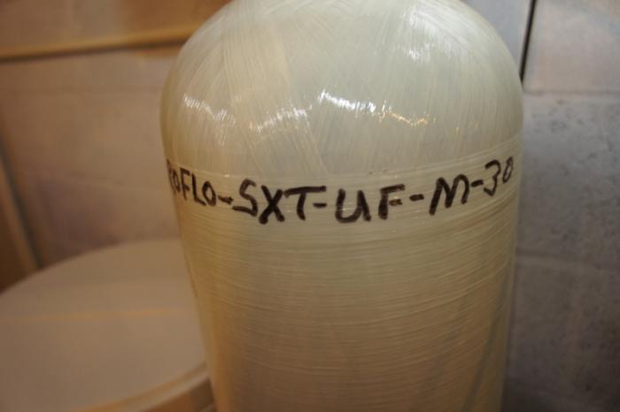

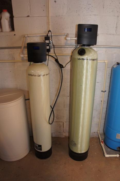

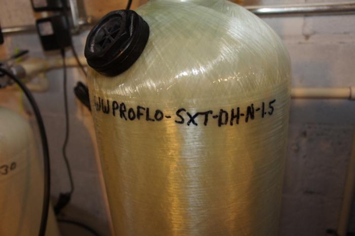

    All, thank you for the suggestions. Looks like I need to outline my equipment to help clarify if the white scale/buildup is a problem with the equipment or an unknown in the raw water.
    The Softener and Acid Neutralizer were recommended, installed, and programmed by a well water treatment company that I hired. They informed me that I had very hard water, iron, and acidity. After equipment was in service, they checked hardness, iron, and pH and reported all were now at desireable levels. I think this equipment was installed back in August.
    The iron oxidation we were seeing in the toilet immediatley stopped with the new treatment system. But within weeks the white buildup and corrosion began occuring in the shower. In December I started researching the issue and got the idea about the Hot Water Heater being scaled up from years of untreated water usage. I flushed it and this seemed to confirm my suspicion.
    I installed a brand new Hot Water Heater about a month ago. I did a little experiment to determine if this solved the buildup issue: evaporated a bit of water captured at the end of a shower on a glossy black dinner plate. Result: A plate of white material (with a definative salty taste). So the hw heater wasn't the answer; however, it needed replacing anyway.
    With my black plate as evidence, I had the treatment company that installed the equipment come back out at the beginning of January to diagnose. This is when they reported that the water was testing soft and TDS was low (which it wasn't - he needed to recalibrate his meter). They informed me that the water coming out of the acid neutralizer was testing harder than before, so they increased the hardness setting on the softener. They also increased the reserve capacity and may have increased the frequency of regeneration to help remedy the white buildup issue. Their best guess was that it was hardness and the increased settings on the softener would remedy it.
    Since then I still have a white buildup if I evaporate off some water. I went through the treatment equipment yesterday and gathered all information I could so here goes:
    ACID NEUTRALIZER
    Valve: Fleck ProFloSXT Downflow (backwashes)
    Tank: Clack 1054
    Mineral: Not sure what they put in
    Programming Parameters (scrolling through master programming mode):
    Valve Type: Filter
    Control Type: Time Clock
    # Tanks: 1
    Day Overide: 5 days
    Regen Time: 1 AM
    Backwash Time: 8 Minutes
    RapidRinse Time: 2 Minutes
    SOFTENER
    Valve: Fleck ProFloSXT Upflow
    Tank: Clack 9X48
    Valve Type: Upflow Brine First
    Control Type: Meter Delayed
    # Tanks: 1
    Unit Capacity: 28,000
    Feedwater Hardness: 36 gpg
    Reserve Selection: Safety Factor
    Safety Factor: 25%
    Day Overide: 7 days
    Regen Time: 2:30 AM
    Brine Draw Time: 60 Minutes
    Backwash Time: 10 Minutes
    RapidRinse Time: 14 Minutes
    Brine Fill Time: 8 Minutes
    Flow Meter Type: Fleck 3/4" Turbine Meter
    Raw Water pH may be as low as 6, according to a test strip I used. The well water treatment company informed me that the AN would also help filter oxidized iron.
    Looks like the softener will regenerate every 7 days? Gary I am going to study your softener sizing link to try and understand these settings better.
    I also checked the peak flow rate since last regen on the softener and it was 2.8 GPM.
    Anything not adding up or look out of the ordinary? Thank you in advance!

    IMO the length of cycle time for backwash and rinse for the filter are not what I would use. I would use 12 minutes backwash and 6 minutes rinse. I am not up on the ProFlo but their days override must be the number of days between backwashes. I would set that to day 4 for 2-3 people as long as you get a pH of 7.0 or higher at all times. Or 3 days if you are running the well pump (assuming a submersible) at less than 30/50 psi. A jet pump probably can't do better than 30/50 psi. I would like 40/60 psi if submersible and a captive air pressure in the pressure tank with no water in it of 39 lbs.
    The softener is way too small for 36 gpg compensated hardness. And I would not have sold you an upflow/counter current type. The length of cycle times are factory defaults with the exception of the rinse, which to me is way too long. I'd set the backwash at 6 minutes and rinse at 4 but I don't know know what they should be for upflow. Default settings rarely work well for any size softener if you want any kind of salt or water efficiencies.
    Until you get the equipment set up right, there's not much sense in evaporating water but it can't hurt. Problem is if the equipment is setup right and you still have the stuff on the plate then, then what? I have never heard of evaporating water on a plate so you may have the same situation but not the stuff on the fixtures in the shower. At least we can hope huh?
    If the driller didn't backwash the filter properly when it was installed, there may be a lot of dust down in the bed and that is getting into and out of the softener and evaporating on the plate.
    Change the times and then put the filter into backwash and when the motor stops and you have a fast flow through the drain line, unplug the valve for like 15 minutes (actually time it) and then plug it back in and let it finish backwashing and rinsing on its own. If you can see the water in the drain line, see if it runs clear or not. If not backwash it until it does run clear. Don't use water while doing that.
    Then set the softener K of capacity based on 60 gals/person/day and 36 gpg and the salt dose per my sizing page and the minutes above. Use one day's total grains as a reserve.
    You have to use the number of minutes of refill instead the lbs of salt. I'd set it for 3333 grains/per lb. You probably have a .5 gpm brine flow but see if it is on the drain line fitting on a sticker/label on the control valve to make sure. Yoiu normally get 1.5 lbs per minute wit ha .5 gpm.
    How many minutes and the instructions should be in the manual for the valve. If no manual goto;
    www.fleckcontrols.com and find one for the ProFlo, there should be an example and/or formula in the manual.
    You will be regenerating quite frequently IMO. I don't see any mention of how many gallons the valve is set for but I would find them and set them and then the override for the number of gallons minus one days gallons as reserve (120 if two people). If you don't set the gallons then the circuit board is doing it.

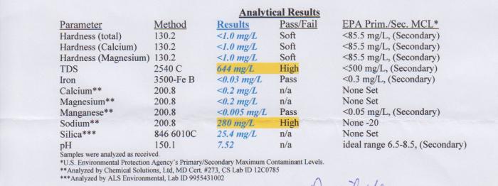

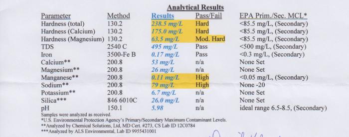

    Hi all - I am back with my lab results! Hopefully this can shed some light on the white build-up issue I am having (as described above).
    Please look over these and let me know your opinion in regards to my treated water causing white build-up. My treatment system consists of a Acid Neutralizer (Filter) and Softener (see post #18 for details). Any RED FLAGS?

    I think my conundrum is that softened water may leave spots, but they should be easy to clean. The build-up/corrosion I am experiencing (photos in post #10) is not easy to remove and has caused permanent damage in less than a year. Thank you!
  9. #24
    6,356
    My guess is the TDS and silica are the cause of the problem.
    Ion exchange softening adds 2 ions of sodium for each ion being removed, so the TDS increases some. A softener doesn't reduce silica.
    A partial cure is to wipe down the shower after every use. it won't remove the stuff that's there but will prevent more of it building up.
    And I'd change the settings of the equipment to what I suggested previously.

    Hey everyone....original poster mrmichaeljmoore here with an update on my water spot saga.
    It's been a while since I've posted, so let me give a quick summary of what I've done.
    I've had 3 water quality professionals come to my house to help me diagnose my water spot problem.
    The first guy (a Kinetico rep) had no idea what the problem was but offered a solution: install a Kinetico system and if the problem goes away, then great! If not and the spotting problem still exists, then he will uninstall his Kinetico system for $200. I passed on that offer.
    The second guy was unsure of what the problems is. I mentioned I had some silica in the raw water (lab tested it 15.9 mg/L) and he suggested utilizing polyphosphate/siliphos. Although he said it was food grade and harmless, my wife and I weren't so sure about adding that to our water supply, so we passed on that too.
    The third guy pretty much said "it is what it is"....he said they installed a whole house RO system for someone with similar problems....obviously, i declined that expensive proposal....
    I recently contacted another water professional. He's a little far from me, but he has been helping me over the phone. He had me do a Langelier Saturation Index (LSI) test with a local lab.
    The results were a -1.5 (serious corrosion) on the LSI Index and the lab stated "Water is undersaturated with respect to calcium carbonate. Undersaturated water has a tendency to remove existing calcium carbonate protective coatings in pipelines and equipment."
    So, the professional had me use a blending screw on my softener to leak a little hardness into the treated water (approx 1-2gpg of hardness). Well, I'm still getting spots unfortunately...and the water is no longer slippery/slick. I think I am gonna try and back off the blending screw a bit and see of that makes the water a little softer... BUT one thing I noticed is that the spots seem to be able wipe off the chrome a little easier than before I used the blending screw....
    That's kinda where I am at right now......I am still gonna tweak the blending screw a bit to see if I can get a mixture that has still has a soft feeling, but that leaves the least amount of spots (that are also easily removed).
    As far as the silica, does anyone have any input on that?
    Are the levels (15.9 mg/L) high enough to cause issues? Has anyone used any siliphos or polyphosphate treatments? Are they safe? Do they work?
    I think I read in an earlier post......someone said spot free water is impossible?? Really? If thats true, thats really disappointing. Are me and ForkWheelDrive trying to achieve something that cant happen.....that is spot free water??
    One other thing: I have noticed that I have some etching/pitting on the glass shower door chrome hinge and chrome screws....Not sure what would cause that....and I did have that before I tried the blending screw....
    thanks.
    mm
