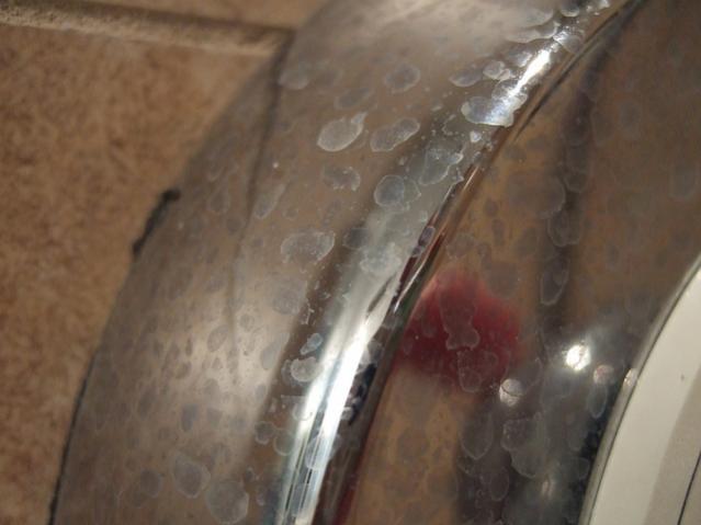

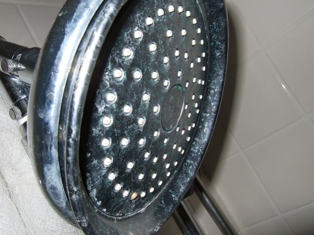

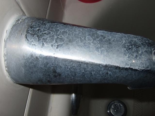

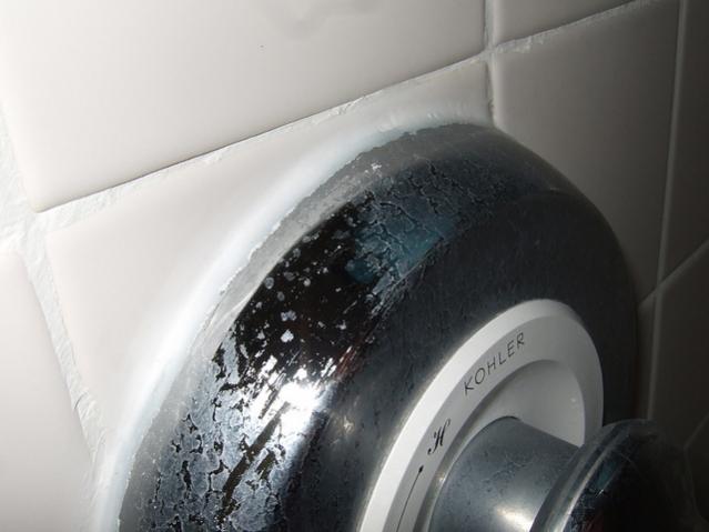

I am having a problem with spots on chrome fixtures.
I am on well water.
Location: Connecticut
Here is my raw water analysis:
Hardness - 21 GPG (grains per gallon)
Iron - 0.05 mg/l (ferrous)
Manganese - ND (not detected)
pH - 7.3 standard units
TDS (total dissolved solids) - 472 ppm
My treated water analysis (done by a local lab):
Copper - none detected
Iron - none detected
Manganese - none detected
Chloride - 11.9 mg/L
Hardness- none detected
Sodium - 110.7 mg/L
Nitrate as N - none detected
Nitrite as N - none detected
Color - 0
Odor - 0
PH - 7.8
Turbidity - 0.3 NTU
Sulfate - 40.5 mg/L
TDS - 364 ppm
My existing water treatment setup:
1. Big Blue sediment cartridge filter
2. Autotrol 255/762 48K water softener (installed in 2006)
3. Big Blue RFC cartridge filter
I confirmed that water is at 0 gpg hardness at all fixtures using a Hach 5B Hardness Test Kit.

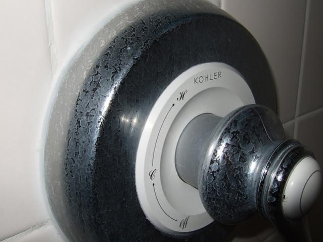

Attached are some pictures. I hope they help in diagnosing this problem.
The pictures labeled Basement Shower (on the beige tile) show fixtures that have been in service only for a few months.
The pictures labeled Upstairs Shower (on the white tile) show fixtures that have been in service for a few years.
As you can see, the spotting/scaling on the Upstairs Shower fixtures is much more extensive.
On both fixtures, I was able to scrape away some portion (not completely, some spots could not be removed by scraping) of the water spots using my fingernail. I attached a picture of the Upstairs Shower Valve after I scraped it....Does that give any indication as to the source of the spotting/scaling?
I tried to clean the Upstairs Shower Head valve chrome handle with CLR.
I put the handle in undiluted CLR and let it sit for about a minute,
I wiped the handle with a sponge. Rinsed with cold water. But the spots still remained.
I soaked it again for about a minute. This time, I scrubbed it with a green scrub pad. The spots came off, but it did leave some faint scratch marks on the handle. So, I wont be using the green pad anymore.
Thanks for the help anyone can provide.
If you need more info to help diagnose the problem, let me know and I will get it to you....

Find some one to do a silica test.
Some of the spots remind of a friend that has a black 4x4 chevy,, mid 70's and it would end up with white spots.. after double and triple checking the softener they he had in place and making sure that it was working and changing out the resin .. the spots continued . That is when we found silica at some thing like 70ppm....
Hard water spots come off, silica will not or if it does it is often with some thing like a pumas stone.

Forget about using CLR. Track down a product from Wood Wyant called Zolvex. It is a commercial cleaner used in the food products industry.

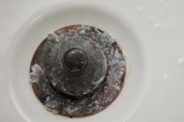

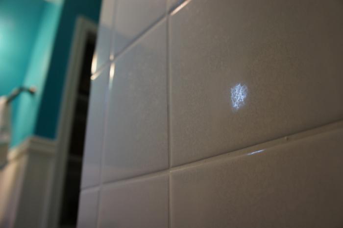

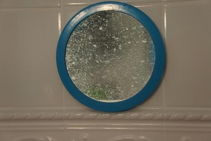

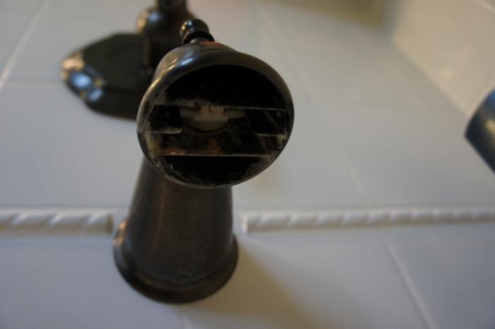

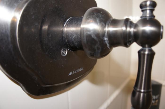

Below are photos of the shower where the buildup issues are most prevalent. The fixtures and tile are less than a year old and have been using the treatment system since they were installed. I think the tile would be ruined if I hadn't have installed white. As stated before, the buildup is not easily removed with water, bleach, or diluted CLR. I will try higher concentrated CLR, Barkeepers, and Vinegar. Thank you!!
Any of this look familiar?? Keep in mind the treated water has always tested soft.

It to me like silica...
Silica will etch glasses in the dish washer and nothing will take it off, it will leave a white ring in the toilet.
If it is silica, not much can be done.
