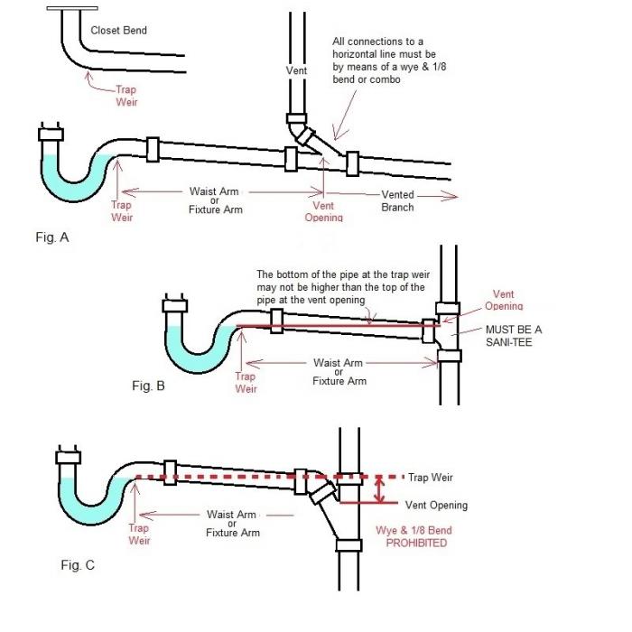

    DIY Junior Member billyh's Avatar
    Feb 2011
    Ontario
    15
    Thanks for the help.
    If you search for "Fixture arm defined" in google, the first hit will have a diagram.
    It states that figure B is correct while figure C is not because the vent opening cannot access the gasses that are isolated at the weir (or exit water level in p-trap).
    Is this not correct?

    Plumber jimbo's Avatar
    9,001
    Quote Originally Posted by billyh View Post
    Yes...the point is that in B the vent opening breaks the siphon, whereas in C it cannot break the siphon. The reason that toilets are an exception to this is that the toilet by normal operation refills the trap after each use. A faucet or tub etc. does not do that.
    I dont understand their arrow in A pointing to the "trap weir" of the closet bend.
    14,191
    There are a lot of ways to plumb for a toilet or a water closet. The drawing above on the closet flange is just "one" of those ways.
    The trap on a toilet is designed to siphon, and then it is refilled after the flush.
    Other traps are prevented from siphoning by the vent.
    25,605
    The closet bend does NOT have a 'weir'. Even drawing "B" would be incorrect if the trap were moved further away from the vent connection, thus raising the "weir". By definition the connection to a vertical line MUST either be with a sanitary tee, or in the case of two sinks, a "back to back fixture fitting", which while it LOOKS like a double Y-1/8 bend is configured to prevent the problem with the trap weir.
