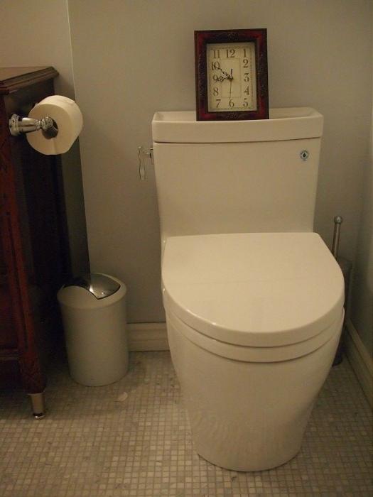

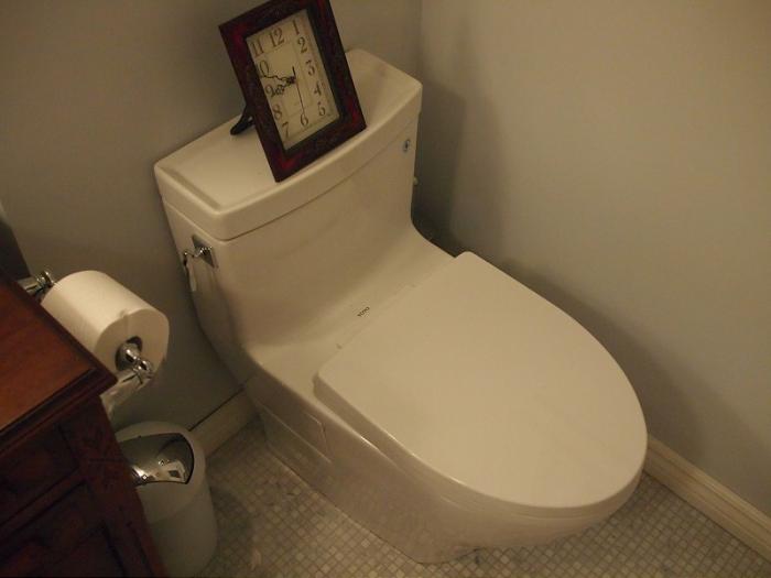

    The Jury is still out, We have a few kids and our current toilets are super-sonic Fushmate powered Eljers. Problem is that they are big, and the bathroom is small. In addition to the Kohler, we also like the Toto options (part of how I found this site) so we might go for the Aimes or similar. Our goal is to get something that is smaller (yet still elongated), and easy to clean (skirted, one piece). I have no problem getting into the wall or moving pipes, but I don't want to mess with the floor.
    Our master bath is "more fun-er-er" ( I have children, they came up with the phrase). Being only 5x7 anything to save space is great. We really like the in-wall tank here: clean lines, easy to clean floor, and my favorite, a toilet height that allows for "more natural-er-er" squat position when in use... In other words, lower. I'll build small bump out so that I don't have to move the vent. That question will come later
    Toto Aimes
