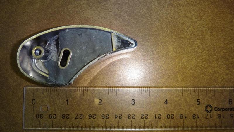

    Quote Originally Posted by ab8 View Post
    I agree too. See photo of lever, likely defective from day 1. I have e-mailed Toto; awaiting reply to see if they are willing to replace lever only for a nominal sum.
    i filled mine with steel epoxy putty - should help. i got the same reply from toto's customer service - basically they were no help. i also emailed their CEO and a few other executives - no reply.Name:  DSC02557 (Large).jpg

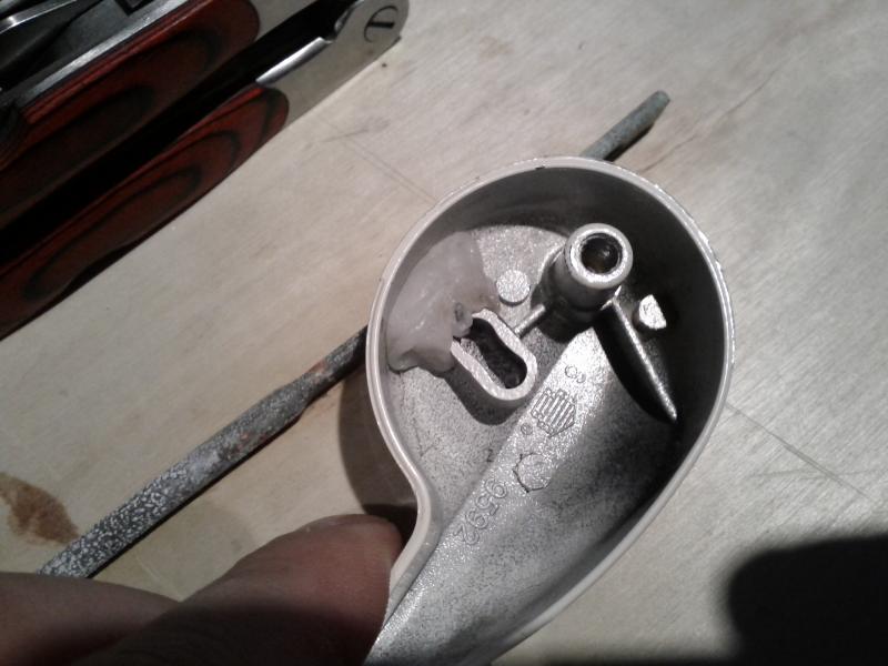

    Default A fix
    Here is how I repaired this kind of lever: I cut 5mm off the end of a wire hanger from the closet (then put the hanger back), then heated up a pinch of polymorph plastic to 70C (with my lighter on a tin altoids lid) until it was clear, then moulded it by hand in to a ball and jammed it into the space above the damaged metal. Then at the now hot plastic filled gap I insted the bit of metal hanger. The plastic cools white, is strong and hard as nylon and the bit of hanger provides a metal wear point that is tougher than the original casting... better than new. I also reinforced the ABS bracket with the stuff since that can break too... 10 minute fix and I used <1% of my $10 bag of polymorph. (oh and I used some lighter fluid too)
