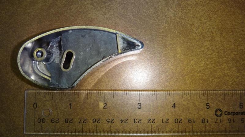

    Quote Originally Posted by ab8 View Post
    I agree too. See photo of lever, likely defective from day 1. I have e-mailed Toto; awaiting reply to see if they are willing to replace lever only for a nominal sum.
    i filled mine with steel epoxy putty - should help. i got the same reply from toto's customer service - basically they were no help. i also emailed their CEO and a few other executives - no reply.Name:  DSC02557 (Large).jpg

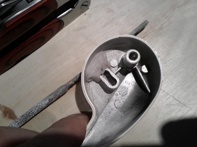

    Here is how I repaired this kind of lever: I cut 5mm off the end of a wire hanger from the closet (then put the hanger back), then heated up a pinch of polymorph plastic to 70C (with my lighter on a tin altoids lid) until it was clear, then moulded it by hand in to a ball and jammed it into the space above the damaged metal. Then at the now hot plastic filled gap I insted the bit of metal hanger. The plastic cools white, is strong and hard as nylon and the bit of hanger provides a metal wear point that is tougher than the original casting... better than new. I also reinforced the ABS bracket with the stuff since that can break too... 10 minute fix and I used <1% of my $10 bag of polymorph. (oh and I used some lighter fluid too)

    A couple of the photos gave me an idea. I had on hand a wooden shish kabob skewer and a stick of JB Weld (epoxy putty). I think this will do the trick, and cheaply. You can find JB Weld at most hardware and auto parts stores. As soon as you put your patch in place, test fit the black plastic screw in part - it rotates, clear any excess putty that might interfere with this before it hardens.
