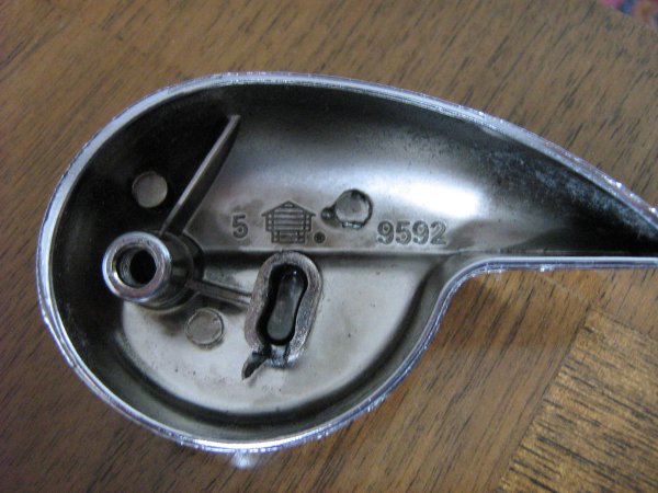

    I agree too. See photo of lever, likely defective from day 1. I have e-mailed Toto; awaiting reply to see if they are willing to replace lever only for a nominal sum.

    Reply from Toto: "The trip lever comes as an assembly only. The list price for the handle is $31.00. The trip lever is a mechanical part and will fail over a period of time. The cost of the part isn't adjustable."
    Sounds like designed to fail. No more Toto for me.

    The Eljer Titan used the same handle as the TOTO.
    Neither Eljer or TOTO made the handles. It's just a generic manufacturer that makes the parts. Same situation for fill valves and flappers.
    You can find plenty of handles for around $20
    By the way, that's a pretty old handle in the picture. I haven't seen those in years.

    Default Plunger OK; got lever for $10 locally
    Quote Originally Posted by wjcandee View Post
    Enjoy re-learning how to use your plunger!
    That's no problem, Toto needed the plunger about 3 times in 7 years.
    A shot of hot water sometimes helps too. YMMV.
    Got a handle locally for $10 plus taxes. Here's an example of good service (Toto could use a lesson or two): I had also sent a blind copy of my e-mail (to Toto) to Paradise Bath and Kitchen, 48 Northside Road, Nepean, Ontario, Canada. An alert staff member, Carlie, noticed my e-mail to Toto and its attached picture, went looking for the part, found one and replied to my e-mail. Exact same part number 9592.
