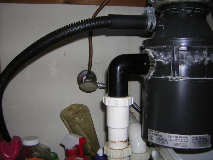

    Those are some pictures of the disposal itself. I believe the white plug on the bottom is power, and the black L pipe coming out of it goes straight to the drain. I'm not sure what the hose w/clamp above the drain does, but I think it goes to the dishwasher.
    Behind the disposal unit is the water, one for hot and one for cold. The one for hot has an additional hose coming out of it going to the dishwasher.
    I'm guessing the hose going in to the top of the garbage disposal is the dishwasher drain? I'm probably completely off here, which is why I'm asking in the first place =)
    But Basically all I'd need to do is turn off the breaker. Then on the garbage disposal snip the power cord, unplug the drain and the dishwasher hose, and then find some way to remove the hose coming from my hot water source to the dishwasher. Once I've done that, I just need to unscrew the garbage disposal from the top, remove it, and replace it with the appropriate pipe?

    Hopefully you bought a complete strainer and not just a basket. Once the disposal is removed, you will need to remove the mount from the sink and replace it with a strainer.
    It is probable that the circuit breaker for the disposal is also providing electricity to other things in your kitchen. As a matter of saftey, you cannot leave the wiring for the disposal in place under the cabinet- it will need to be removed.
    Unless you really dislike having a disposal, I would just buy another one of the same type. It would likely install on the existing sink mount and you wouldn't have to do anything but swap out the unit.

    Looks like yours is a Badger 5 which are fairly easy to replace ===>

    Do NOT get that disposer. Get an ISE, Emerson, Kenmore, or similar with the "bayonet mount" like yours. Then you just have to unfasten the dishwasher hose, and drain tube. Then "rotate" the locking collar to the left, throw the disposer away, put the new one in place and rotate the collar to the right, then reattach the drain tube. DO NOT connect the dishwasher or remove the plug from the dishwasher connection until you have a dishwasher that works.
