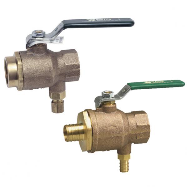

    14,221
    Ballvalve, that part is a Pressure relief valve. All water heaters have a pressure and a temperature relief valve.
    And like you mention, they only release at 150 PSI.
    It's much better to have an expansion tank to take up excess pressure long before it reaches that point. If pressure is allowed to ramp up to 150 PSI, the flex on the inner tube of the gas water heater is taking a real beating. After a while the flexing back and forth starts to break the welds in the tank, causing premature failure.
    And this is why, for all the non-plumbers out there, that an expansion tank would be "required".
    Even if some of you "don't get it" we do.
    The plumbing code isn't written by Dummies for Dummies. Gee..........I'm feeling pretty smart right about now. But then, I am a plumber!
    Shut off with "pressure" relief. These have a small spring that will release for Relief Valve Pressure Settings: 75, 80, 100 or 125psi http://media.wattswater.com/es-BRV.pdf
    But again, they release water if the pressure gets too high. An expansion tank prevents that from happening in the first place. It gives room for expansion, not letting the system reach that high a pressure.

    Thanks for the photo. Most plumbers probably did not know these existed, including myself until a bit of research. Most seem not to care, so let me try and explain my point. [The "YOU don't get it" was directed to a DIY'r not the plumbing industry]
    As you mentioned, a expansion tank will be stressed at its max at 149PSI, and very likely an older one will break the bladder.
    Then the last resort is the T&P valve, which as we all have seen on videos, the failure thereof cause a missile launch, unless your supply lines hopefully and likely broke first. More than a few homeowners have fixed a leaky T&P with a pipe plug....
    Since maximum pressure safety and water line breaks have been such a subject of threads here, it seems adding a mid level pressure release is a very cost effective move.
    If you have a expansion tank, adding a simple 8$ adjustable relief valve [not the combo shown in your photo] and setting it at 100 PSI, means that the tank takes pressure increases from say 50 to 100 without opening any valves.
    Then if you get to 100, a few tablespoons of water out the valve prevents over stretching the bladder. When that valve fails, the last line of defense is the T&P and your old toilet supply line. If they hold, you might make the evening news.
    Since I have given up on complaining about expansion tanks, I simply propose that a mid-level relief valve preserves their integrity, and makes the 150PSI T&P a true last resort.
