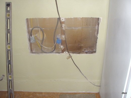

    I was wondering how I should go about running my drain line? I was planning on using a plumbing outlet box for my drain but I am not sure that will work to well. I am planning on putting my washer on the left and sink tub to the right.
    I want it to look neat and not just run the washer drain into the tub.
    If I run the drain in between the studs and in to basement where does the trap go? Or I can run it through the wall into the basement. About 18 inches off the floor I can drill a hole and run my drain there.
    Jan 2008
    3,155
    The trap should be at the bottom of the standpipe, above the floor. It will also need a vent, which must go through the roof or into the attic to a point where it can tie into an existing vent through the roof.

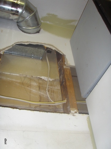

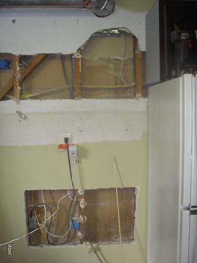

    Jan 2008
    3,155
    The vent can run horizontally (with pitch towards the drain) once 6" or more above the flood rim of the sink, so it can go through the roof wherever it needs to be.
    There are very few situations where a proper vent cannot be run.
    DIY Junior Member dbol's Avatar
    Dec 2010
    Southwest PA

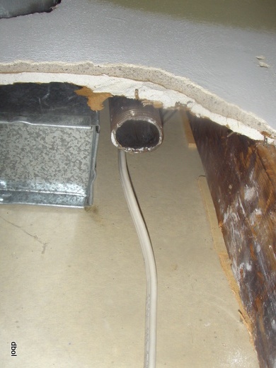

    Major relief. I took out another section of plaster wall and found the old vent pipe that was disconnected. I should have no problems with the vent pipe now. There was a cap on it above the roof so I took it off and ran a snake down and found it was clear all the way through.
    I was hoping to just use a fernco and connect the new to the old. Or is that too lazy.
    I am running 2 inch abs does the vent also need to be 2 inch?

    You can use a banded coupler, of which fernco is one brand.
    Because you are working in an attached garage, you will also need to make sure that the replacement wall board you install meets the requirements for a firewall. I believe 2 layers of 5/8 drywall will be required, but again, that would be something best answered by your local inspector.

    The vent only can be 1-1/2". However, if the existing pipe you found is 2", I just stay with 2". Since this is above ground connection, be sure you use the banded coupler and not the plain neoprene sleeve with only 2 hose clamps. Those are only approve for buried work.
