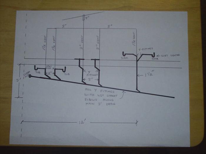

I am also guessing there is no exact requirement as to the height in the wall of the trap arm connection as long as it meets the rules of common sense ??? ( Terry, I like that rubber hose idea ). Here is my latest attempt at meeting the Canadian Code but really appreciate all the advice both Canadian & US. Your opinions please on this latest drawing.
