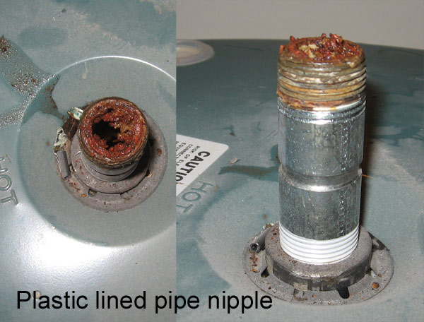

    25,633
    quote; Only the real cheapo water heaters don't come with unions factory installed. Any reputable brand will supply factory installed galv nipples which are lined with plastic...
    1. I have NEVER seen a water heater with unions factory installed.
    2. Apparently you have never seen "dielectric nipples" which have delaminated with rust between the plastic and steel..
    3. the idea is to get separation between the two disimilar metals by using a material which is between them in the Noblility scale. Brass is that material when it comes to steel and copper.

    1. Whoops, by factory installed unions, I meant factory installed nipples.
    2. You are correct, I have never seen laminated nipples suffer from that much corrosion.
    3. I use dielectric flex hoses to make my transitions, however otherwise I use cast brass FIP adapters or tank tees when hard piping with copper, I'm sorry I wasn't more specific for your liking, heh.
