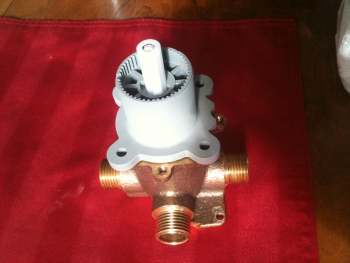

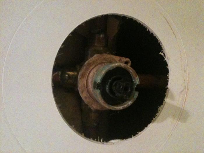

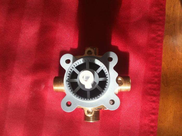

    changing from an old price pfister trim to a new price pfister trim.
    the new trim came with a different valve, because it's a clockwise/ccw control for cold and hot and on/off.
    the old trim though is a cw/ccw for cold/hot, but a pull/push for on/off.
    so, the valves or valve stems are different. please excuse any incorrect terminology i have. thanks
    i don't have access to go behind the wall, and i don't want to do any soldering. i wish i can just take the valve off the new piece and replace the valve on the old piece with it. would this be possible? will you help me on this process?
    attached are some picture(s) of the old (current setup)/new valves. thank you,
    matthew

    Call the manufacturer - they should be able to tell you if things will fit. If not, then you'd need to replace the valve body. They make remodel plates to cover the larger hole you'd have to make to install a new one if you can't get to it from behind. This will require some cutting and soldering, though. Maybe time for a plumber if you aren't up to this yourself. Technically , not hard, but if you've never done it, by the time you buy the tools, a plumber might come out about the same. But, you'd have acquired a new skill and some new tools, so it may be wash, and cheaper next time.
    25,651
    You CANNOT just replace the operating mechanism. The two valve bodies are completely different and incompatible. You may be able to make the hole as large as possible and replace the valve body that way, BUT you will definitely have to do some, in fact a lot of, soldering, with the potential of starting a fire inside the wall. You could also destroy the shower walls, which would make it just about the most expensive replacement you could come up with, especially if you spent additional money buying tools and parts. Call a plumber.

    Not to be too harsh on you.....but you have asked if you can buy a new body for a chevy and put in on your ford. Shower valves and trims are matched sets....they are generally not interchangeable between different MODELS of the same brand, and NEVER between brands.
    25,651
    quote; NEVER between brands.
    While that is generally true, given that many manufacturers DO produce their items for other brands, i.e. the old Crane single handles and Moen being interchangeable, it could happen, but not in this case. But this is a question about interchanging between models from the same manufacturer, and that is also not possible in this case.
