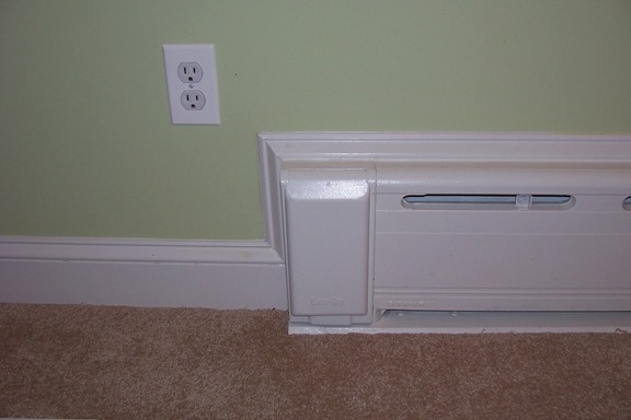

    The tough part about designing fin-tube baseboard for water temps below 120F is that it's response with temperature is no longer a linear or predicable funciton- the convection currents induced by the difference between the room air and the water temp begin to fall off rapidly, and can be adversely affected by things like dinged/bent fins or even dust-kittens that accumulate between vaccuming of the baseboards. Radiators and radiant-type cast-iron baseboards continue to have predicable BTU output even at 85-90F water temps. With fin tube you're still getting something, but it's not consistent- there's no way to reliably specify how many feet of it you need to deliver a particular BTU/hour rate to the room with temps lower than 120F.
    Triangle-Tube boilers really are great & all, but there are many good condensing boilers out there. NONE are any good without the right system design and technical support though, so be flexible about manufacturers if heating contractors suggest others, but look up the specs yourself, and be prepared to discuss what the minimum-modulation vs. peak & average heat load of the house is. Even the tiniest mod-con can support your hot water load with an indirect-fired tank, but even the nicest boiler is a dog if it's minimum modulation is well above your peak heat load, which is why you really need a good heat load calculation for the whole house to pick a boiler, or to design the system to work efficiently around any particular boiler. You need the room-by-room heat load numbers both to get a good balance, and to be able to deliver the heat at water temps low enough that the boiler works in condensing mode most of the time. When the water temps returning to the boiler exceed 120F by very much the efficiency drops pretty rapidly to the ~ 87% mark, then more slowly with rising return temps. If it's set up with radiation that requires 150F water even when it's only 40F out, it'll almost never condense, and you'd only get about the same efficiency out of it as a much cheaper tiny 30-50KBTU/hr 2-plate cast-iron beast.
    Flat-panel radiators that might be appropriate look kind of like this:
    But there are also things like heated towel-rack radiators, or designer radiators for the tres-chic designer types that'll set you back a heluva lot more per BTU delivered:
    So, there are alot of options- the thin steel panel radiators are probably the least expensive unless you're dropping all the way down to fin-tube baseboard. Cast baseboard is going to run you $40-60/foot, which adds up. (Those can be had used as well, for a half price or less.) Euro-modern & designer panel radiators and towel racks turn into real money real fast too. I personally like to go with recycled Burnham Sunrad or Radiant or similar 5" deep cast iron in classy older houses (they can be sandblasted & repainted quite easily with auto-body type paints- no need for high-temp paints since you're not running steam here), but the sizes you need might not always be readily available on the local used-market. (But they are from the Burnham distributor for only half a leg and one arm. :-) ) But you'll know better what YOU want, and where.

    Cast-iron baseboard looks like this, and will deliver ~210 BTUs per linear foot @ 120F water temps, 125 BTU/ft @ 100F:
    And classic radiant-type convecting cast-iron radiators that work well at low temp and "architecturally appropriate" for a '30s vintage house look like this:
    Burnham still makes the "Radiant" series, but they're often available used at lower cost from recyclers and antique home outfitters, etc.
